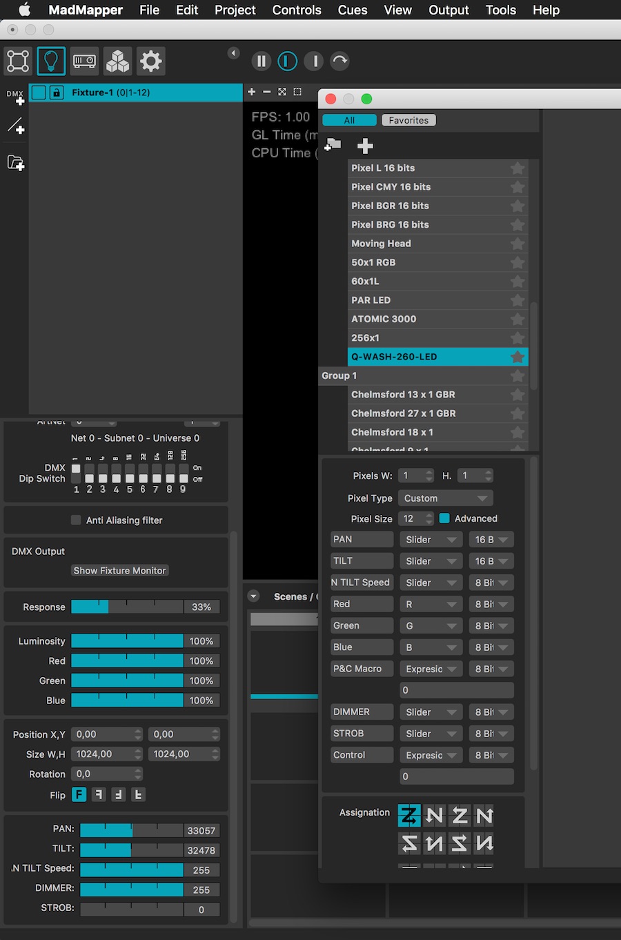

    hey GUYS having a bit of trouble trying to work out mad light i have the manual for my wash moving head and with a friend that has made profiles for ma and hog but he says this is entirely different and cannot work it out. Fields and everything are different. go to find suit on mad mapper website and ERROR NOT FOUND. is there a service were i can upload the user manual(dmx addresses) and be sent back the mad light profile or if not a link to the information i need to be looking at. Thanks again heaps for all your help.

    Here is the fixture definition file for your device & a screenshot of the setup:
