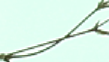

    by geoffmatters » Sat Nov 10, 2018 4:26 am
    Here is a sample showing the poor quality direct to m8, and the nice quality if I add black syphon to the signal chain
    bmtis 1080i59.94 m83.0 sample.png (24.1 KiB) Viewed 9019 times
    bmtis 1080i59.94 bs m83.0 sample.png (44.94 KiB) Viewed 9019 times

    Unfortunately, with this camera 1080i at 59.94 is the only format where the Shuttle will pick up the signal, so I have not been able to test with a progressive format. 1080p24 should work but doesn't. If I get a chance I will try testing input from a different device...
    Note that in my original description I mentioned "half vertical resolution" but from the screenshots it looks like there is a loss of horizontal resolution as well.

    Okay, I am changing my story back, zooming way in on the screenshots there is twice as much horizontal information as vertical. Certainly interlacing is a suspect...
