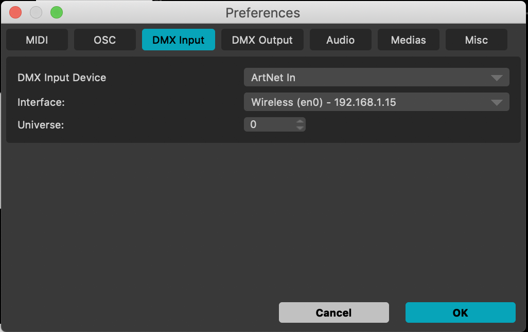

    1- In MadMapper preferences / DMX Input, choose ArtNet / your network interface / universe 0.

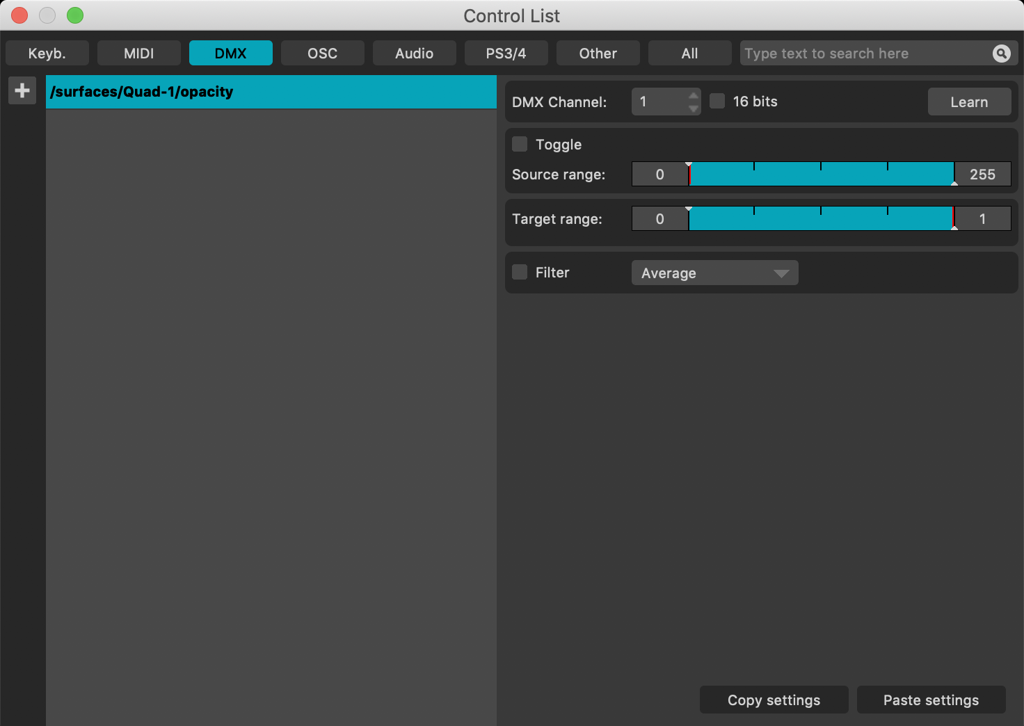

    2- Create a quad and right click the opacity slider / choose "Add DMX control" / make sure the control was creating with DMX channel 1 (the 1st channel of the input DMX universe)

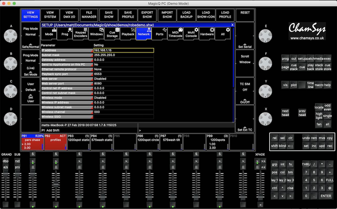

    3- In MagicQ / Setup / View Settings / Network, set the IP Address to the same address chosen in MadMapper preferences / DMX Input.

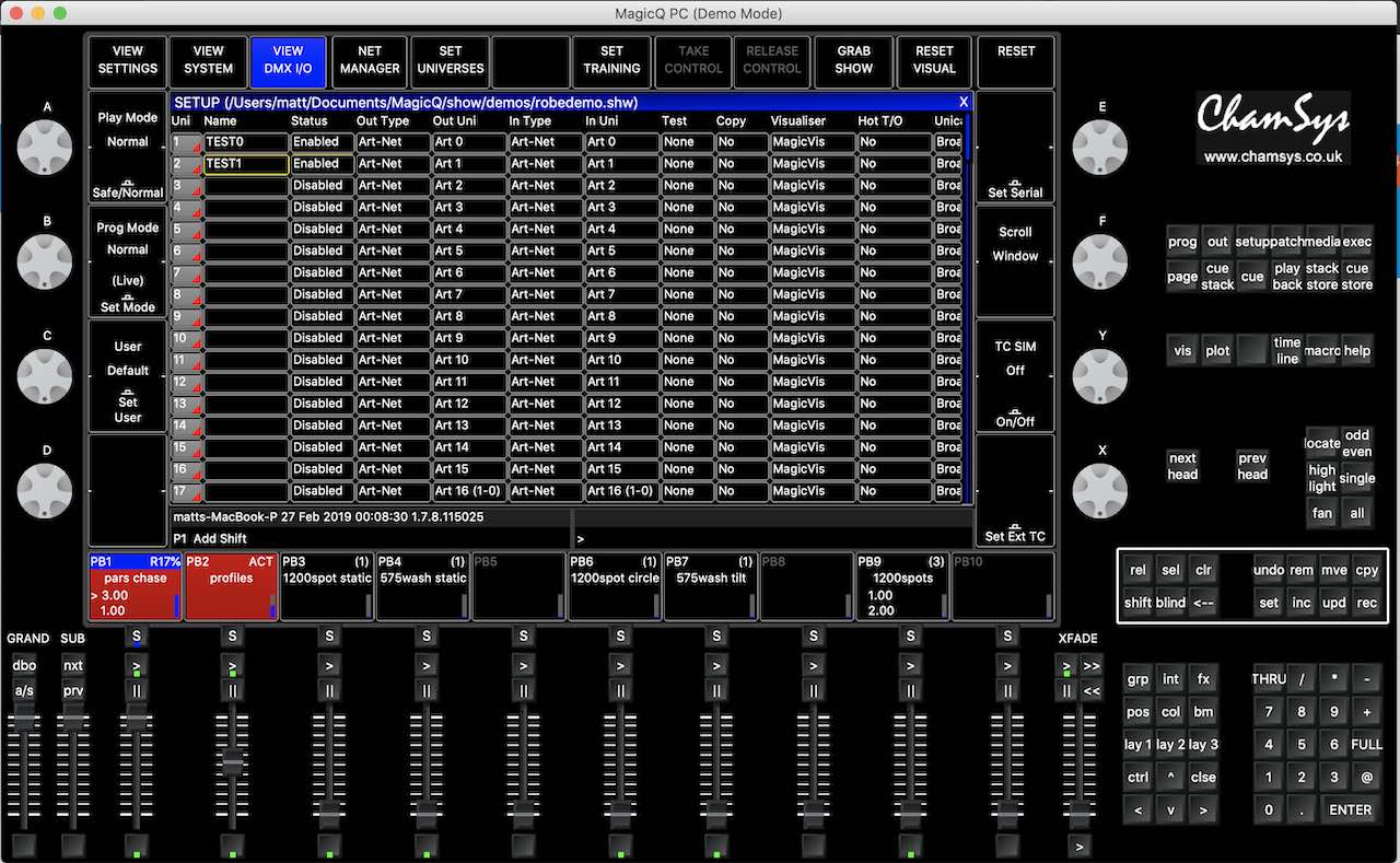

    4- In MagicQ / Setup / View DMX I/O, setup the first universe: "Out Type" to ArtNet, "Out Uni" to 0, don't change other settings.
    Now if you patch a dimmer (in MagicQ) on channel 1 of MagicQ Universe 1 and move it, MadMapper will receive the data.
    Screenshot 2019-02-27 at 00.08.30.jpg (177.32 KiB) Viewed 4704 times
    Screenshot 2019-02-27 at 00.07.58.jpg (178.9 KiB) Viewed 4704 times
