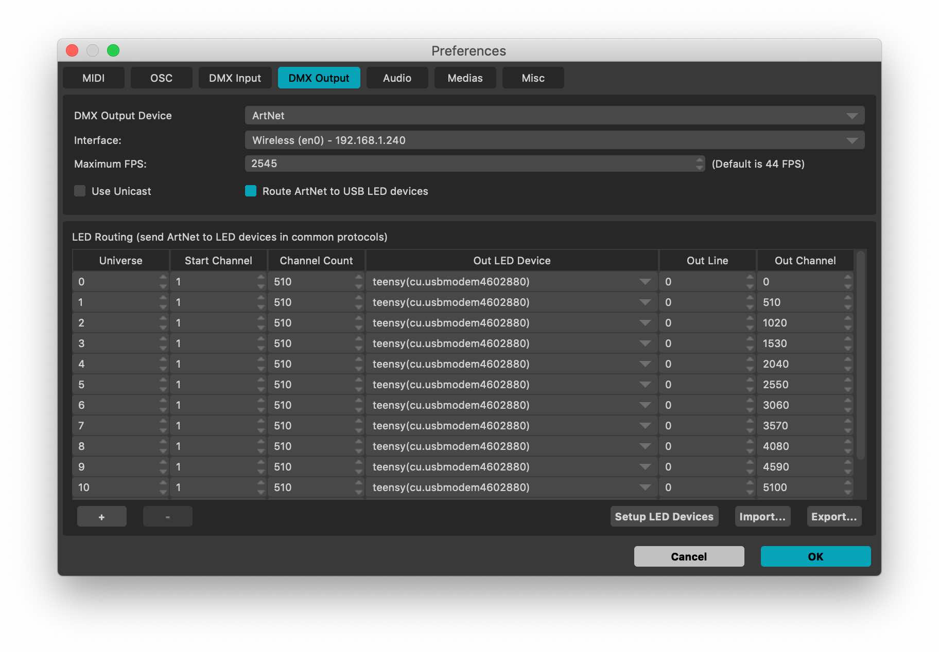

    I have a DMX output setup with 2 separate controllers connected over ethernet (Pixlite 4 Mk2). Unlike when routing through USB, where I can assign different universes to different USB controllers, I don't see the option to do so for ethernet controllers. In short, I'd like to route a set of universes to controller A, and the other to controller B. How do I do that?
    Screen Shot 2019-03-21 at 9.00.12 PM.jpeg (93.06 KiB) Viewed 3431 times

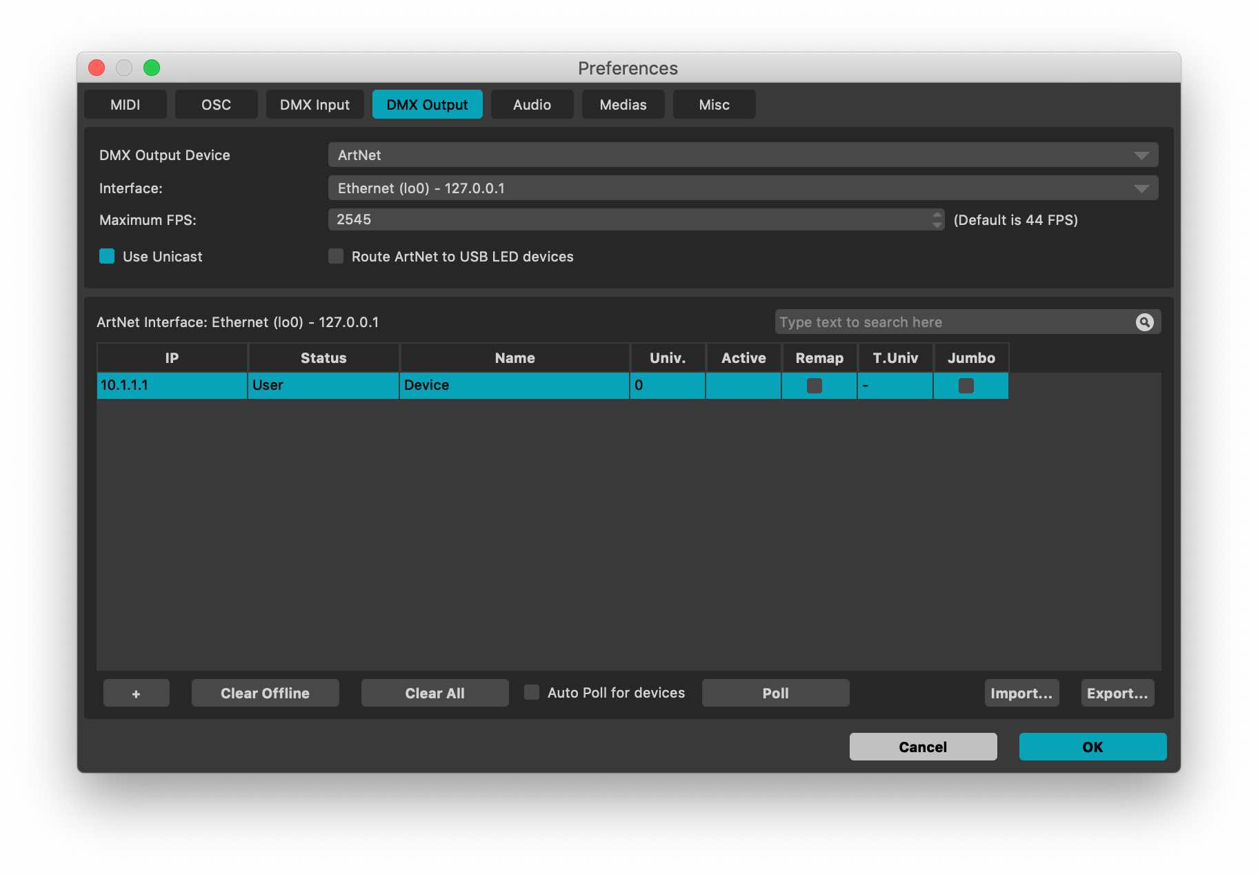

    Screen Shot 2019-03-21 at 8.57.20 PM.jpeg (121.56 KiB) Viewed 3431 times

    by mad-matt » Mon Mar 25, 2019 3:19 pm
    You disabled ArtNet Polling. Just check the option "Auto Poll for devices" below the ArtNet unicast table and you'll see your two Pixlites. MadMapper will automatically send the universes where needed (ArtNet polling lets us know who's on the network and which universes devices are listening to)
