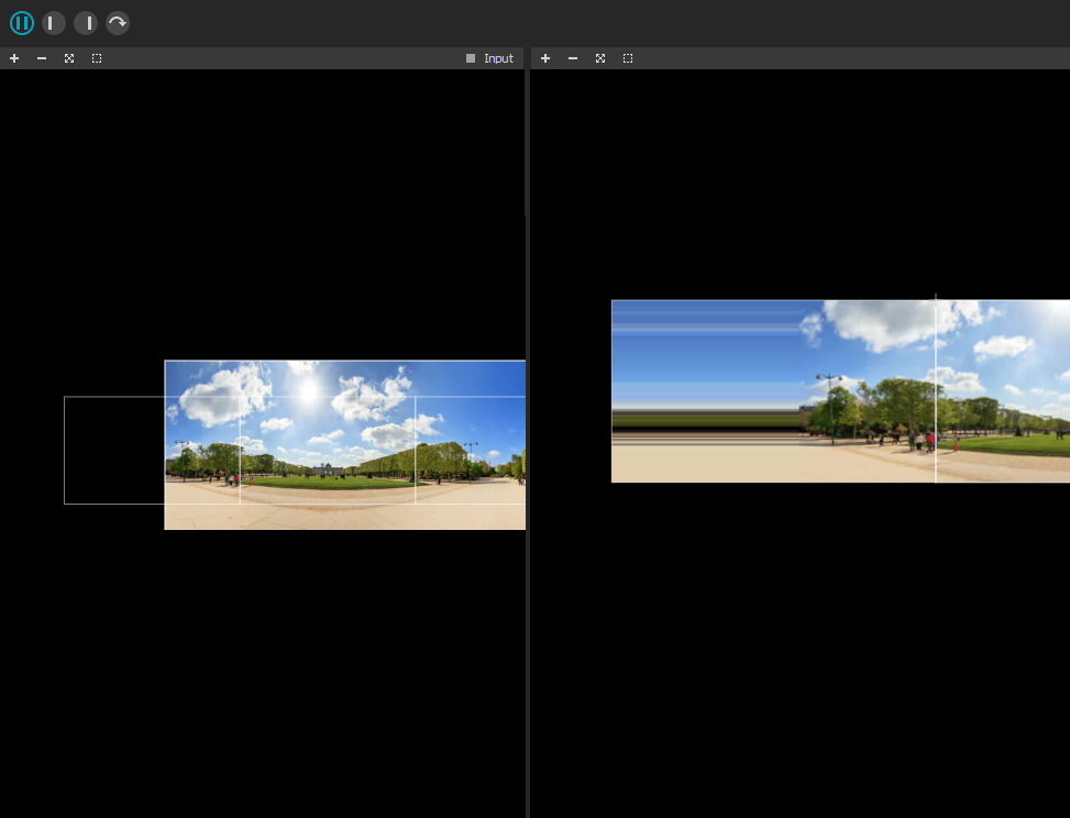

    by themarra » Fri Sep 13, 2019 5:19 pm
    Here I have a screenshot of the panoramic video in the program, as you can see the output isn't what I wanted
    Posts: 1556
    Re: Projecting Circular 360° Videos
    by mad-matt » Sat Sep 14, 2019 1:57 pm
    Sorry I forgot the attachment. Here is the file. Yo uhave to unzip it (I couldn't attach a .fs file in the forum)

  • themarra
    Posts: 7
    Joined: Mon Sep 02, 2019 11:55 am
    by themarra » Thu Sep 19, 2019 12:12 pm
    thanks madmatt, it worked well.
