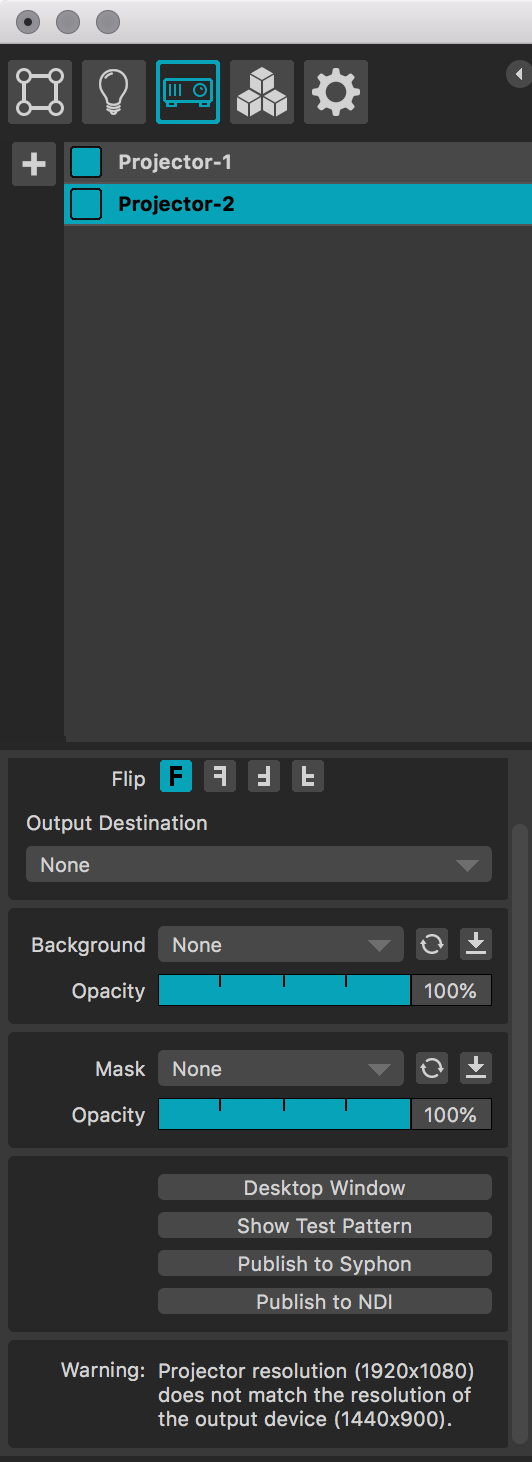

    Indeed - but - I guess I was asking "HOW" to do that -
    Found out via a FB user group.
    It's under the "projector" button - then "manage outputs" - in case anyone else needs to know how to find it.
    THx.
    jL
    Screen Shot 2020-01-16 at 5.29.43 PM.png (96.64 KiB) Viewed 6071 times

    since you were already using it for modul8 I thought you just wanted confirmation that it was the only solution
    so Publish to Syphon, I just made a few tests with the MM4 beta, and a couple of other older versions, sometimes syphon recorder didn't work - just need to relaunch the app though
    + they recently updated SR with Catalina and h264 support (thats great)
