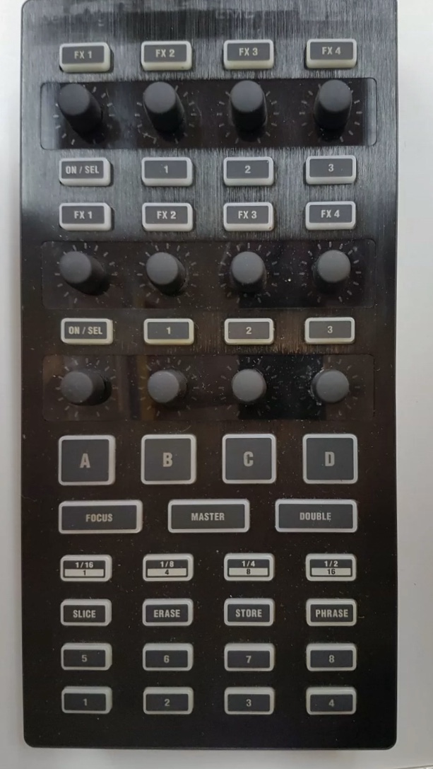

    Hi, I have been trying my best to search for a way to program the Behringer CMD DV1 midi controller to use with M8 and Im not having much success. Half of the controller is fine. Pads are assigned to trigger clip s but the encoders are relative and only send a signal that moves any fader by 2 points then get stuck. Id like to assign the encoders to opacity as absolute values but cant find any way to alter them, even tried using a midi translator on OSX. My other issue is that the other buttons seem to be non assignable, no midi signal is detected when I press them in learn mode in M8.

    Here is a pic to explain more. The bottom pads work fine but the encoders and fx pads are the problem as mentioned above

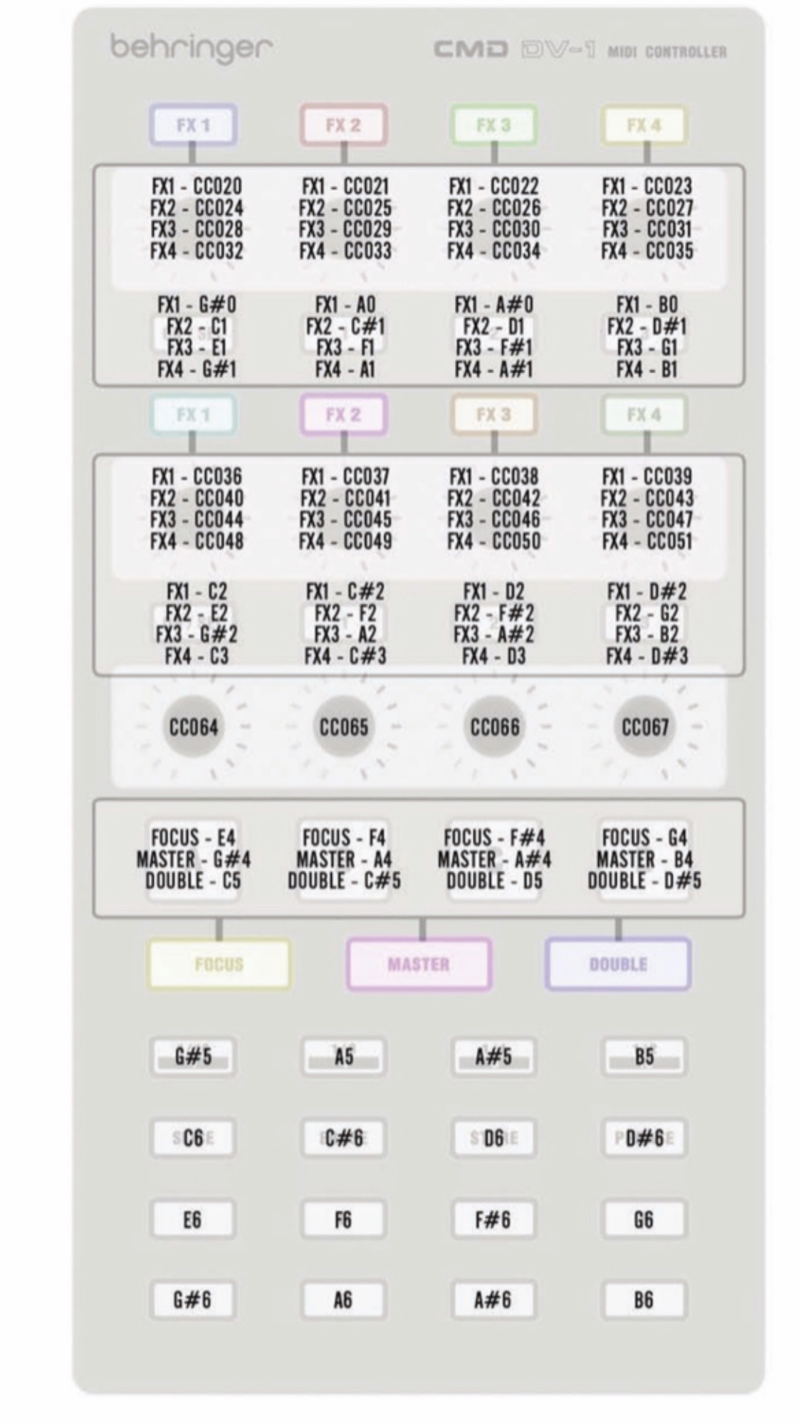

    Hi Geoff, many thanks for the reply and info. I have conducted a test and found that the first encoder at the bottom left is sending on CC 64 and the values 63 for a left turn and 65 for a right turn so nowhere near 0-127 for full off and on. The opacity layer Im trying to control for layer one just gets stuck at 50% when turning left and right on the encoder. I dont think there is much I can do about it without an controller editor for the unit!
    I have included a midi diagram just in case it sheds any light on a workaround.

    It looks like the buttons and encoders in the top half change their MIDI value depending which FX/Focus/Master/Double is on.
    Unfortunately M8 doesn't understand encoders (as you observed, the controller is sending standard CCs, so most software will treat it just like a knob near the center position)
    You have to find or write a module. I have an "LB - Arturia Beatstep" which controls layer opacity and would be very easy to modify to respond to your device. But at the moment uploading to the online module library seems to be broken.
