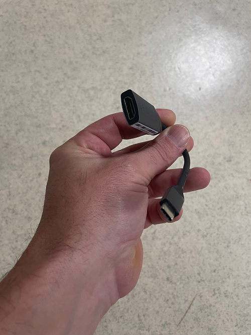

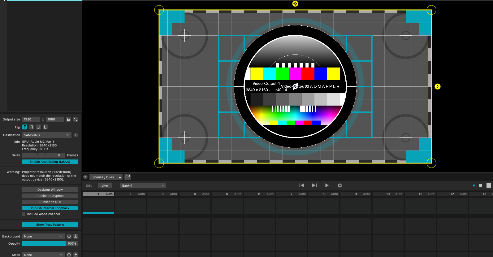

    Although I correctly recover the input streams (I can assign an input in a quad and I see my video stream), I do not recover anything in output by assigning the madmapper output to the SDI output of one of the decklink duo 2 where I connected a SAMSUNG TV monitoring screen.
    The strangest thing is that, wanting to test in a different way, I connected a USB-C/HDMI adapter to the Macstudio to connect the SAMSUNG monitoring TV (recognized as a secondary screen by MAcOs) but assigning it as output to the MadMapper output, nothing either....
    I checked my Madmapper configurations several times, everything seems good to me.
    I did tests with Millumin with the same connections and everything works...
    I'm lost...
