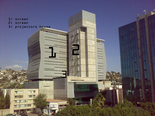

Hi there!!
thank you very much guys for your help... in fact, i want to show you a picture of the building and the projectors that we are thinking will be the best options, and the lenses too!! i hope u can check it out and give some advise about it!!! The projectors are 2 FLM R 22+. And we've just watched these options too (http://www.bhphotovideo.com/c/product/7 ... _with.html.)
And we think that with the TLD 0.73:1 (http://www.bhphotovideo.com/c/product/7 ... _73_1.html.)
We can guarantee the correct fit and development of the screen. For mapping, we will use Modul8 and MadMapper and the keystones that these projectors have. For media, will incorporate 3D animations, that will be made in the right resolution according with the projectors.
Thank you again!!
Re: Blending 2 SXGA+ projectors
Posted: Tue Jan 31, 2012 9:49 am
by sigmasix
the orbital head thing is not really useful and you can spare some money using the regular version of this projector.
from experience, barco is not a great long term investment too, but this will definitely do the trick.
the perspective doesn't help much but your projectors house seems very close to the building. maybe that's why you consider the orbital head? in this case, you might have some lightness problem (very light at the bottom of the building and darker at the top… not to mention resolution drop).
But with this kind of projector and this kind of building you won't have too much trouble. the residual light from the buildings around can be your biggest pain.
Posted: Tue Jan 31, 2012 10:13 am
by INAUDV
Indeed, the short range that we have for place the projectors has been, until now, our biggest doubt about the viability of the project. But searching and of course the budget will take us to these options to achieve the goal. This gonna be, in case of approving, a permanent installation. So the thing that you mention about the Barco brand is really concerning to me. We were considering Christie too, but their prices are a little higher.
Posted: Tue Jan 31, 2012 10:18 am
by INAUDV
And, for incredible that it can look, in B&H in New York, they have it in stock, a FLM r22+ with the orbital head in a lower price than the normal model, and thinking about our lenses options, is worth it to buy this orbital head model i think.
Posted: Tue Jan 31, 2012 3:05 pm
by sigmasix
I was there when the guys setup the projectors and si I remember, the signal was only splitted into the 4 projectors and they used the internal keystone and lenshift of each projectors. They have a software to control the projector using rj-45 connection.
In the end it was exactly like using one projector. I used mad mapper to correct the images an other guy created based on a photo he took with his camera from around the place we placed the projectors.
easy cheesy ;)
