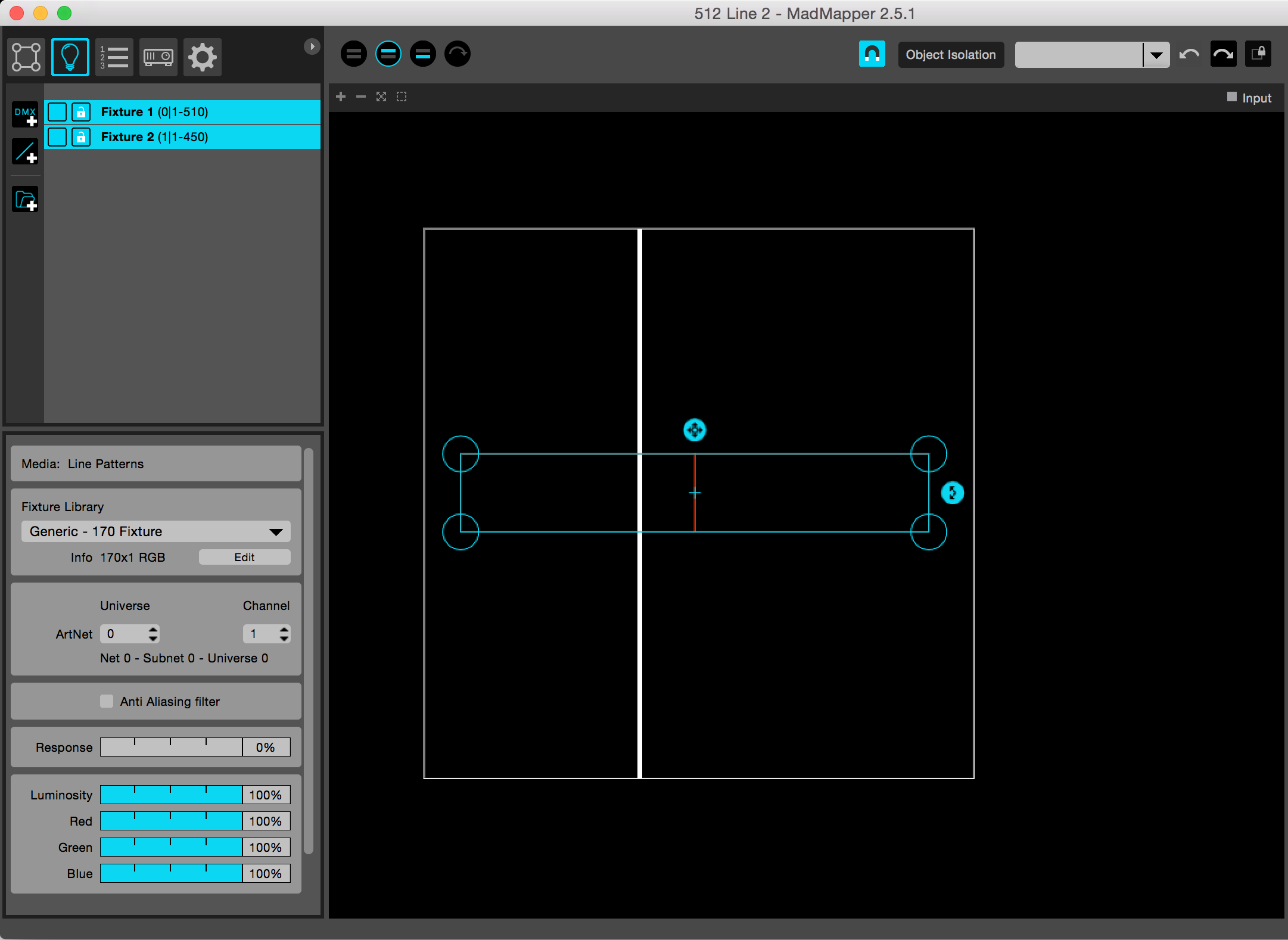

    Is there a way to make a circle with the DMX LED fixtures? I can only create lines and my circle is too wide to individually pixel map. Is there a quicker way? It's only 3x 5 meter of WS2811 making a 50' circle. Right now I have lines :(
    Thanks
    Screen Shot 2017-10-26 at 9.38.00 AM.png (181.61 KiB) Viewed 5108 times

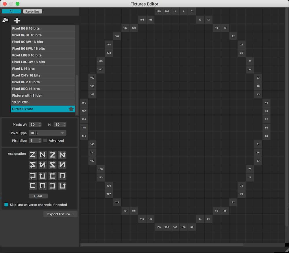

    by mad-matt » Thu Nov 02, 2017 3:22 pm
    You can use a big squared fixture and patch pixels individually inside the fixture. Check the attached picture
