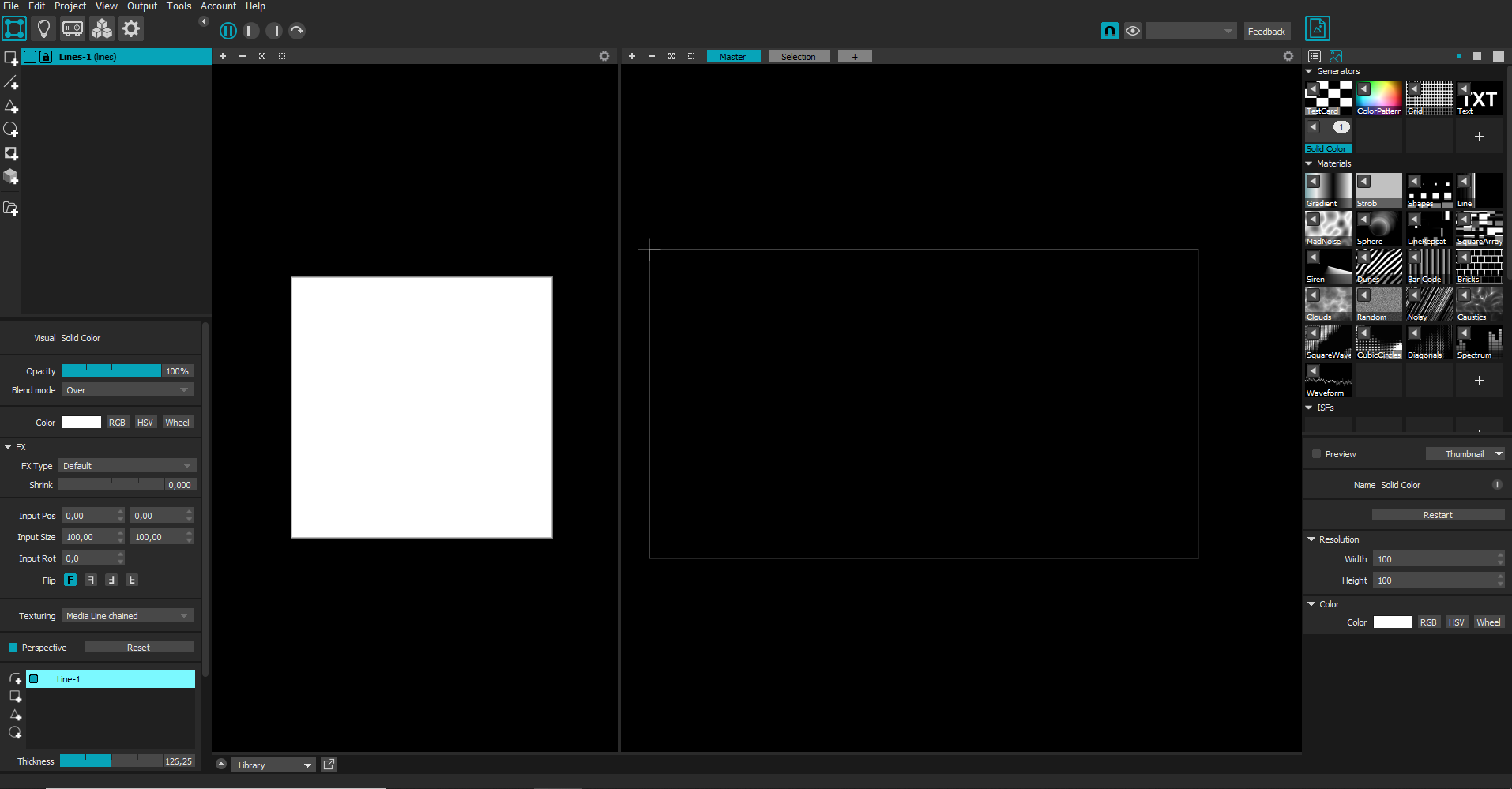

    But it's the other one that interests me, the SVG lines import. In this case, nothing appears in the output preview : i can't handle anything (see the screen capture when the SVG file is downloaded with menu File / Import SVG Lines)

    yes, i can tell you. Nothing happens...
    When i try to import a SVG lines, normally under perspertive / reset, the lines of the SVG lines must happears but i my case nothing as you can see in the screenshot i've sent before in this topic.
    Of course, i try to change the "thickness" but i must have some lines to aplly this "thickness"

    by twann29 » Mon May 10, 2021 4:46 pm
    to make me understand:
    here is what it gives with another laptop
    as you can see, I have all the lines (up to selection-9) and on the right the logo "TRISKELL"
    doing exactly the same thing with the same SVG on my machine here is what I have:
    I don't have up to 9 selections and the "TRISKELL" logo does not appear at all on the right
