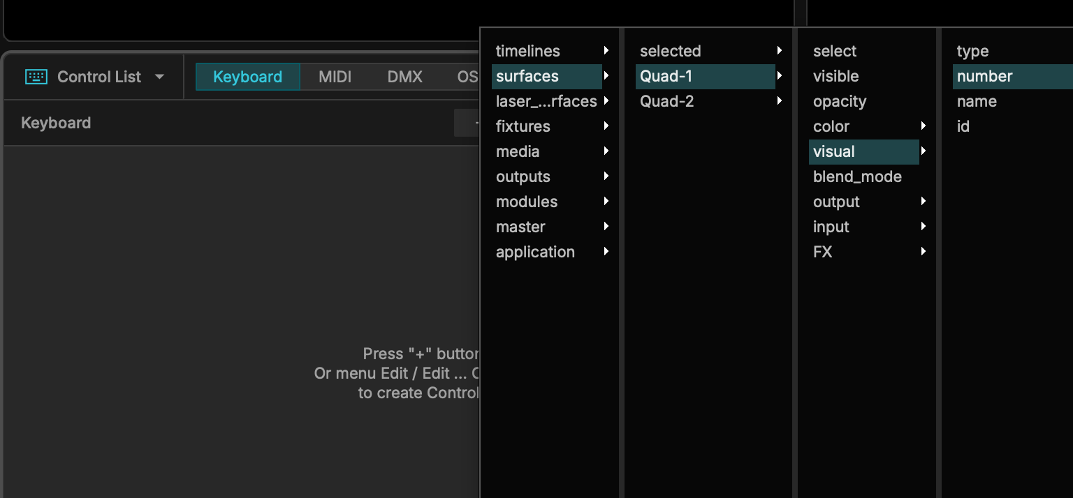

    I cant seem to assign media select on diferent DMX channels it seems you can only have one this is very frustrating
    You can add controls to set the visual type (generator, movie, image, camera...) & number (in this type) using
    /surfaces/Quad-1/visual/type
    /surfaces/Quad-1/visual/number
    in a busking environment i want to be able to fade up a layer and scrub through media contnet
    You mean you want to fade down and scrub so you can see the new visual in the output preview even if opacity is 0% ?
    You can do it using a loopback. See: https://www.youtube.com/watch?v=3Xh0CtOqPJU
    Since you use 3 layers you can create one loopback per layer. So for the 3 layers, you have one Quad for rendering your visual in the loopback and another quad to show the loopback on the output. You assign the opacity control to the quad that shows the layer on the output.
    It might be nice to have a 3rd fader per layer for the blend mode +
    No problem doing it
    Screenshot 2026-08-10 at 10.33.16.png (106.53 KiB) Viewed 4 times
