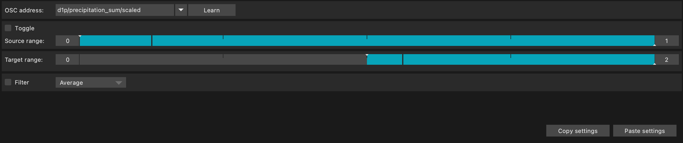

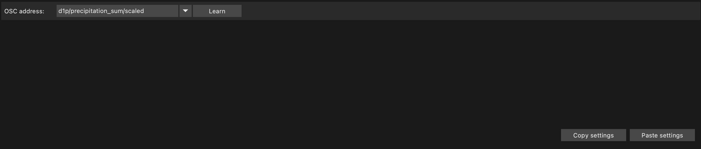

    Found a bug here, that might have been the connected of this problem I'm experiencing.
    BUG: mapping a osc value to pos y will only work, but trying to show the input value in a text box next to it at the same time automatically changes the value for all receiving instances of that value to have six decimals, thus making it not work for the pos y any more.
    In the attached images you can see what happens to the value mapped to pos y when a second osc mapping of the same input is added.
