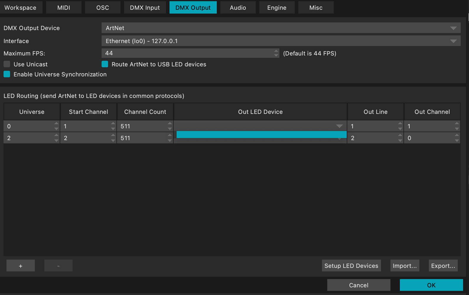

    I've been trying to control my pixel strip via Teensy3.2 + Madmapper. I was following this tutorial online, - everything went fine, but when I try to connect my teensy from Madmapper preference window, Teensy does not appear on the Out LED device list :(
    I was able to upload the file via Teensyduino, example file works but I cannot find my teensy on the list....
    Is there someone who has any idea on this ? Tips? Thank you in advance !
    Screenshot 2023-01-04 at 13.28.21.png (123.21 KiB) Viewed 2660 times

    THe teensy will not appear if the serial port to communicate with it cannot be opened. Please close teensyduino, it certainly keeps the port opened and both apps can't use the serial port at the same time
