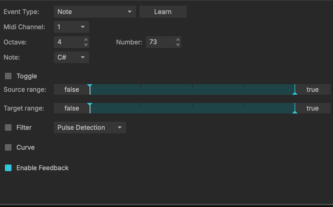

    I'm using a Launch Control XL by Novation (mark 1) with MadMapper 6.0.9
    I've mapped my buttons to Madmapper parameters.
    If I set up feedback mode, the LED of the buttons on my controller won't light up.
    However, if I press the parameter buttons in the Madmapper UI, the LED on the controller do light up.
    If I deactivate feedback mode the buttons LED will stay off.
    I used midi monitor to check what it send to MadMapper and I can confirm no MIDI signal is sent back when I press a button on the controller.
    Is this a bug?

    What does Protokol show?
    https://hexler.net/protokol
