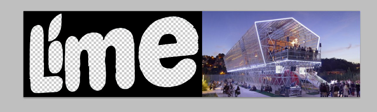

For license exchange ask the support, obviously they'll see what they can do.
Meanwhile, to try to answer your problem, MadMapper doesn't import vector shapes.
MadMapper works with RGBA pixels. For vectors to be imported into MM, they need to be converted as pixels,
and the process is called rasterization. We don't have a rasterizer, so far.
But you can rasterize your vectors yourself !!!!
Using Illustrator and export them as RGBA images.
To make a mask out of them, export using an alpha channel (the A in RGBA).
Good formats for alpha'ed images are PNG files (save as 32bit, 24bits for RGB + 8 bits for Alpha).
In MadMapper, use the blend mode "over" or "over premultiplied".
You can now composite your bitmap masks over something...
If you own Modul8, you can even make one big composition with your bitmap logo mask and all your media side by side.
Then in MadMapper composite your mask over each of your surface...
Understanding the general principles behind MadMapper is probably the key to solving your problem.

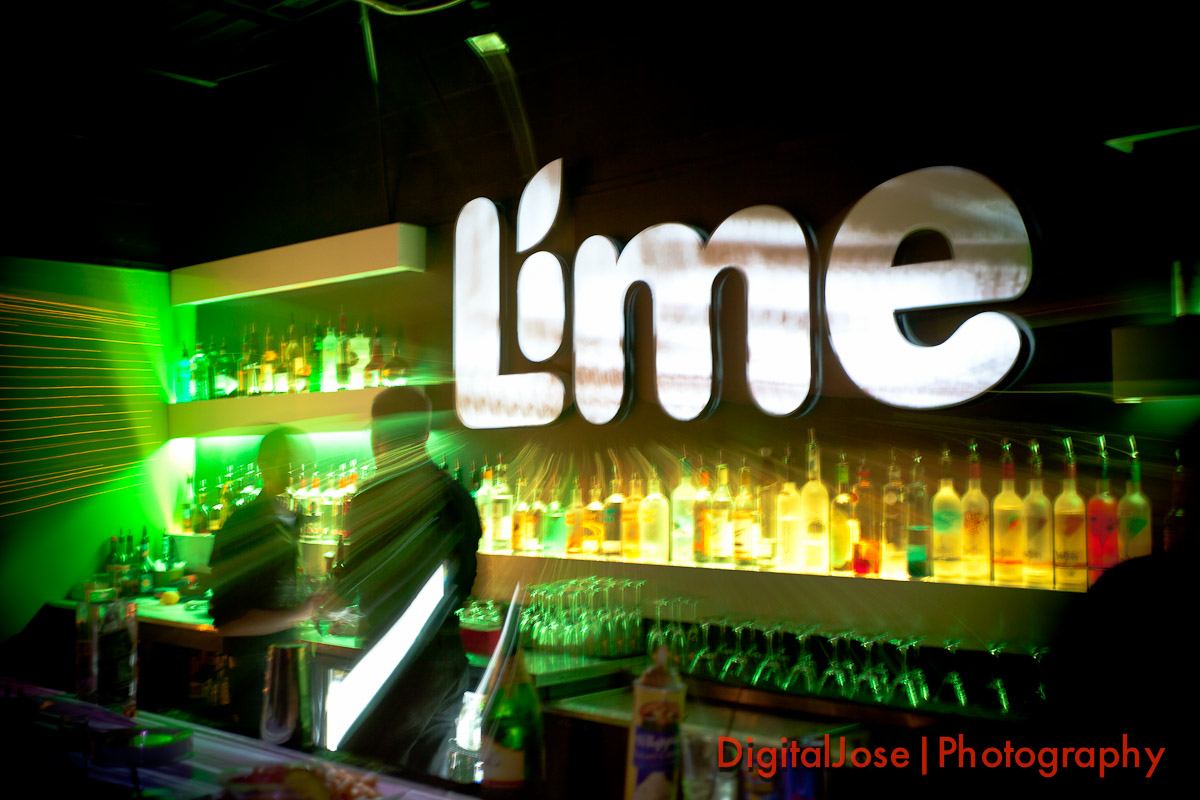

Just to make it clear what I'm doing (and I'm currently doing it with Modul8, not MadMapper), see the following image. I'm projecting video the Lime letters with video...

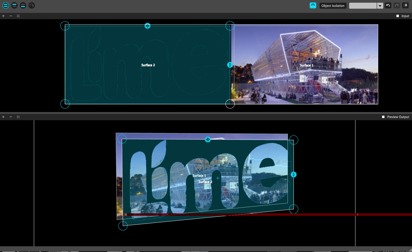

first picture : in photoshop (or after effects, or in modul8 with video)
your mask + your content, with alpha, saved as png (or any format preserving alpha)
second picture: in madmapper, 2 quads...

and the 2nd pic:

Thanks for the illustrated tutorial :D I may give MM another shot, though not likely on this particular project (I'm also running another three projectors to do a bar top--not shown in the photo)...

It is, and I have one that I use for a different application. However, here, I have a total of 5 projectors installed (four on the bar, one on the logo)...
