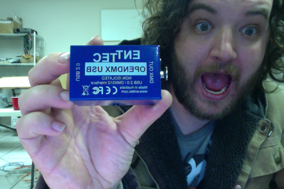

    by soupvisuals » Thu Feb 07, 2013 4:29 pm
    The EntTec website says there are no drivers for this for osx unless your running like 10.4 or older, which i am not.
    there is an enttec open dmx usb, here's a photo of mine
    should the second bar in preferences be greyed out next to USB PRO? ... now 2 days to show time.
    Photo on 2-7-13 at 9.26 AM.jpg (183.68 KiB) Viewed 102869 times
    Re: Madlight, EntTec DMX USB, madmapper 1.4.1
    by franz » Thu Feb 07, 2013 5:48 pm
    hey, never noticed this one.
    my bad, there is, indeed, an Enttec Open DMX Usb.
    We currently do not officially support this model.
    We officially support, so far:
    - Enttec Open DMX (ODE) : Artnet to DMX
    - Enttec DMX Usb Pro : USB FTDI based
    There are however some drivers for your open DMX USB Pro (at least linked on Enttec's site):
    http://www.enttec.com/dmx_usb/D2XX1.1.10.dmg
    http://www.ftdichip.com/Drivers/D2XX.htm
    Did you try to install them ?
    nice beard btw
