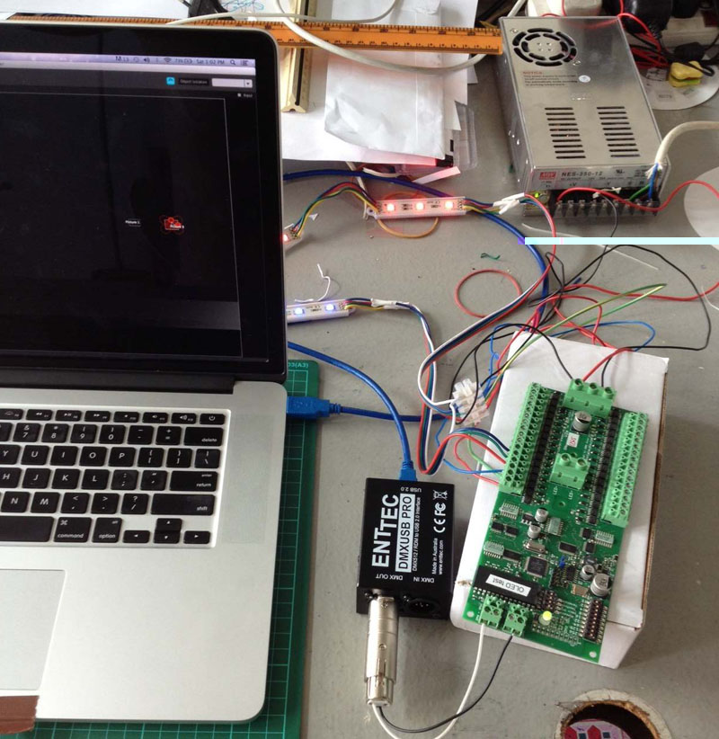

    total beginner here with LEDs+madmapper+dmxusb pro, so heres my question.

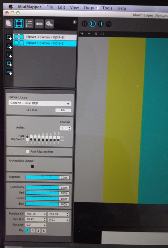

    i've got everything set up. LEDs do change color and all that, no problem. but when i try fading my visual colors in madmapper say from red to blue, it just jumps from red to blue,. theres no fade at all. its like its only On/Off, no in betweens. kinda sucks cuz i cant do fade to black even!... am i missing anything? thanks in advance!
    my setup ;-
    - madmapper 1.5.2
    - ENTTEC DMX USB PRO
    - DMX 32 Channel Board
    - RGB Leds strips
    - 29amp power supply

    Did you try to tinker with the Response curve ?
    That's exactly why we added this option.

    I'm having the same problem: lights are either on or off, no matter what I do with the response slider. No fading. Can't figure out what I'm doing wrong.
    When I try moving a white cube through syphon across the fixture, the light either goes on or off as soon as I pass the threshold of 50% of the fixture covered.
    When I have the cube covering the fixture entirely and instead I fade the intensity in and out in Modul8, the little DMX indicator square on the MadMapper screen fades as well (and the DMX values do change continuously too when I check the DMX values display in the latest beta version of MadMapper) but the light just flips on and off when I pass 75% light intensity.

    did you activate the anti aliasing filtering ? (in the inspector panel)

    by storsjo » Wed Nov 27, 2013 8:19 pm
    Ah! No I hadn't. Works perfectly now. Thanks!! :D
