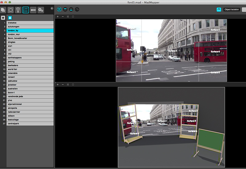

    Hi there!
    I am trying to solve a problem. I use Madmapper for a theater production that is going on tour. The technicians have to reset or adjust the surfaces on the projection areas/sets every day. Since I have a lot of the projections on excatly the same spot I have used the same surface for most of the projections. My problem is - since I want an easy setup I don't want to reset all the surfaces - now that it create individual surfaces. I can't figure out to just set up the main areas to let my movies/photos go through. Let me say I also own modul8. The main idea is to run it through Qlab. I have attached a screenshot to show it here. I am using these 7 quads for all my projections, but not always all seven at the same time.
    Thx in advance
    Michael
