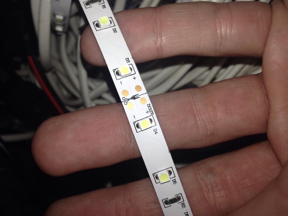

    the positive/negative poles are important on the strip. You should be able to identify it, since that should be printed on the strip on every cut marks - check the attached picture. SMD3528 strips - usually - "negative controlled" which means they handle the PWM signal on the negative pole. So, the positive part should be attached to Vout, and the negative should be attached to CH1 on the DMX decoder.

    Thanks for great help (as always)! I have cut down the LED strip to a 30cm piece. The fist good 50 cm of the LED strip is unmarked but further up I found the positive/negative marks. I was using the positive pole for VOUT as I thought.
