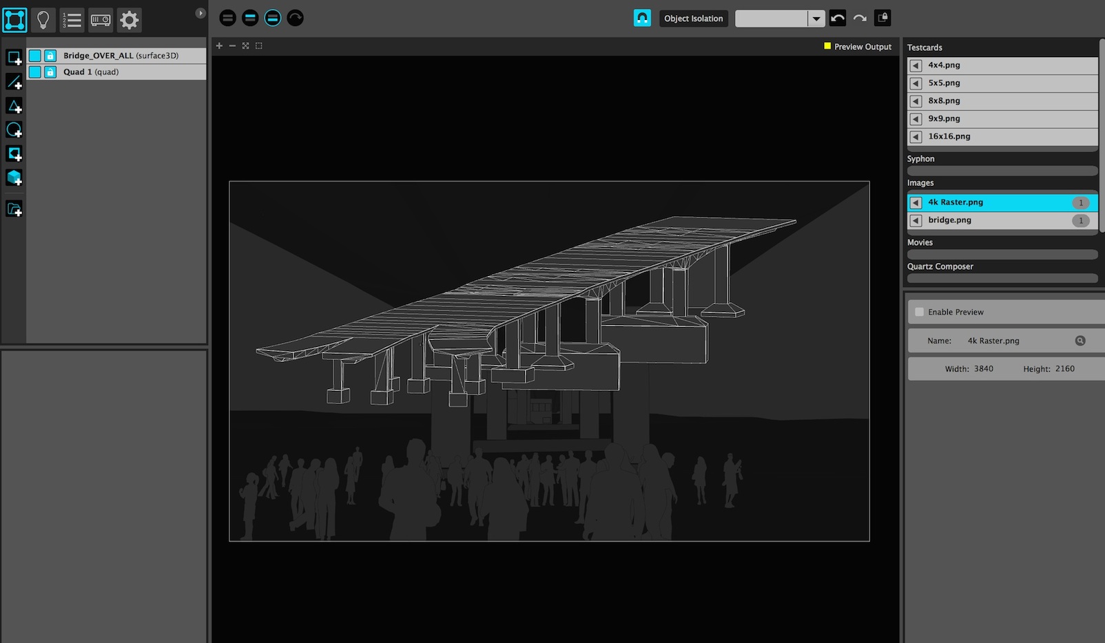

    I am trying to calibrate an OBJ of a very large structure (a large bridge in a city centre). Right now I am just trying to setup a rough perspective under the bridge as a sort of "pre-vis". The issue is MM seems to load 3D objects with a totally flat, isometric perspective and you can not manually position a camera to look - for example - inside a room or under an object with perspective. I rendered a perspective POV from the 3D model and tried calibrating points based on that. Once I have all 6 points lined up very accurately, the model just disappears. I should be looking under and down the length of the bridge model with the object going overhead and behind me.
    Whats going on here? is this some sort of camera clipping issue if a model extends out past and behind the camera in MM?
    A basic camera placement tool in MM would be really helpful to use 3D objects...

    Here is an example of the type of perspective I am trying to calibrate - a view from under the object (the bridge).
    Here is how things load into MM:
    Note, I am just using the background image as a reference to try position and align the 3D model.
    Each time I try and calibrate, the model just disappears. If I play with the calibration handles and try editing it, I can get it to flicker in and out but the perspective is not anything close to what I am trying to line this up to - even though the vertices are lined up very cleanly on the reference image.
    thoughts?

    OK, I've had a look at your files.
    - 1 make your render the same size as the output: 1920*1080 for instance. make sure the ratio is the same
    - 2 crop your 3d object to the visible parts. your bridge is very long, to calibrate on your view you don't need half of the bridge
    - 3 make a rendering without the people, this will help you to set the points at the right place
    - 4 make more remarkable points : maybe subdivide the top of the bridge
    - 5 make sure your calibration points are NOT coplanar: they should be all on a different plane.
    in your mesh, I have problems finding non coplanar points
    - 6 while calibrating, you can still rotate your mesh by pressing the "r" key, this will help you select good points
    - 7 as a sidenote, your mesh seems to be different from your 3d rendering: the windows do not exist on the 3d object,and the back wall doesn't have the same proportions.
    let me know how it goes, or send me(through the support) updated files
    On the other hand, I don't think you need 3d calibration to map that bridge .... it will be easier to map it manually.
    Usually, 3d calibration is for contained complex objects, not minimalistic large scale building.
