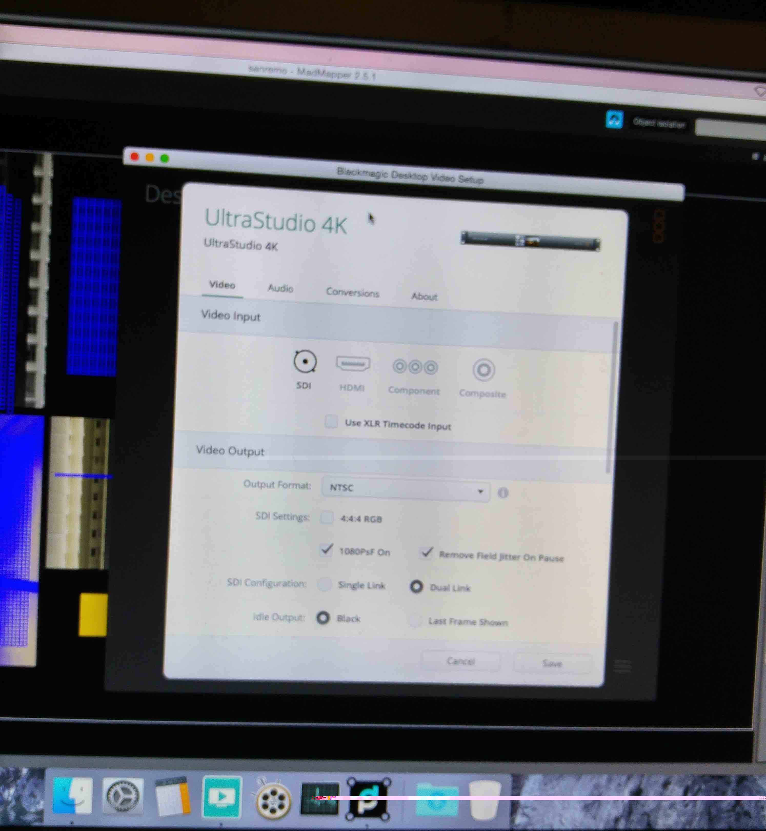

    In MM what did you chose as "Video Format" ? (ie 30p, 60i...)
    Can you send a screenshot of the settings in MM and the capture preferences in BlackMagic Desktop Video ?
  • simo86
    Posts: 7
    Joined: Wed Jan 18, 2017 3:39 pm
    Re: Madmapper and Blackmagic Ultrastudio 4K
    by simo86 » Sat Jan 21, 2017 8:43 pm
    In MM the setting is 1080p50, in the Desktop Video I cannot see any setting about the video input.
    I attach a immage of how it is setted now to capture SDI signal, perhaps I did not understand what screenshots you need.
