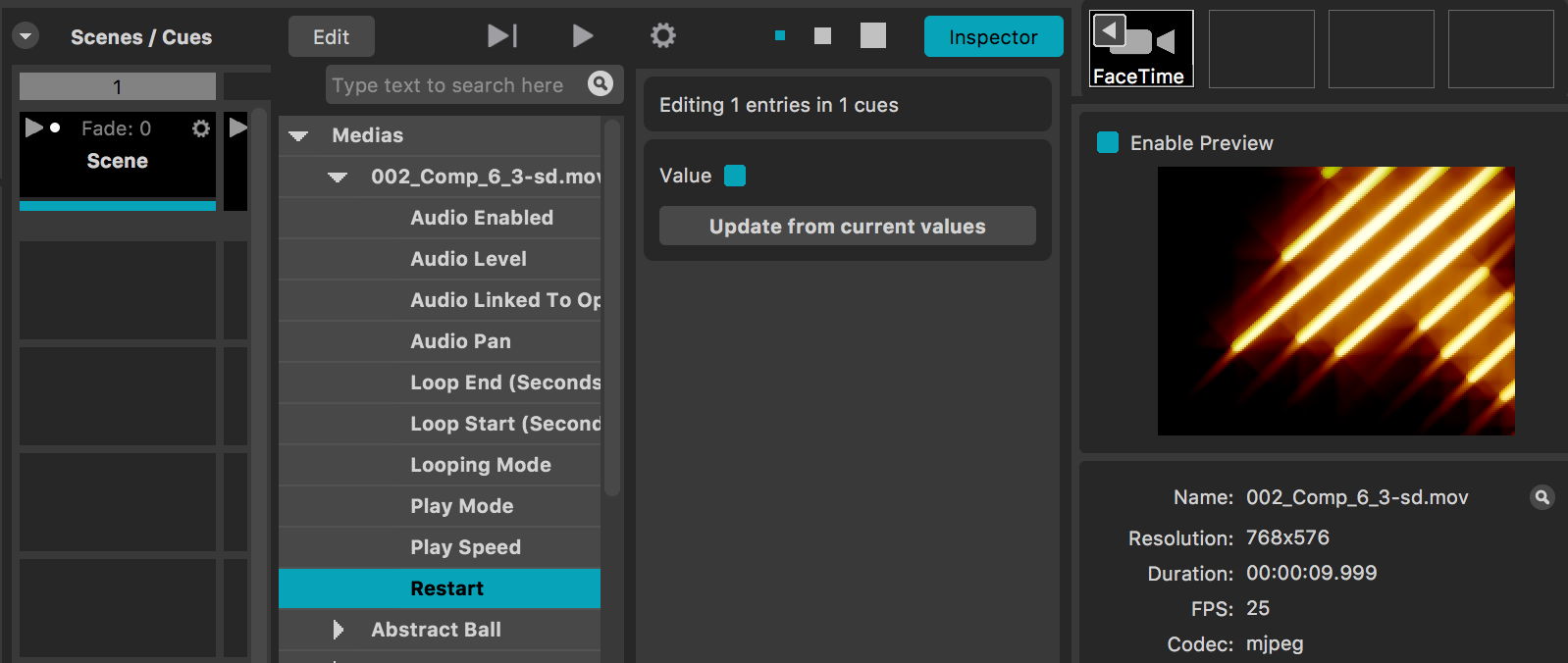

    Hey all! New guy here! A simple question but I can't seem to figure it out. I have videos that play in madmapper. When I change scenes, I'd like it to play from the beginning of the video. From what I can see, it is always continually playing so as I switch to the scene, it's showing a random section of the clip instead of starting it.
    All I'm trying to do is map out to where I activate a scene it the video plays automatically from the beginning. Is there a trick I'm missing? Thanks :)

    open the cue inspector, select your media (within the selected scene), select the "restart" attribute, then check the "value box" on the right
    Screen Shot 2018-09-21 at 17.46.22.png (194.89 KiB) Viewed 7693 times

    You rock! Thank you! :)
    Sometimes this box will uncheck itself if you make changes or update the scene.
