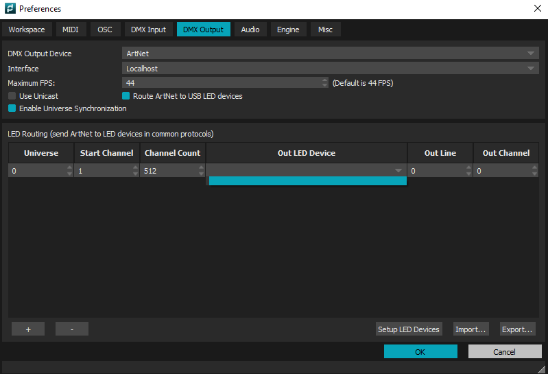

    Hello!
    I was wondering, if seeeduino xiao could be used instead of teensy for controlling pixel strips. Their specs seem to be quite similar. I could upload the code with no problem, but later in MadMapper, the software didn't recognise it as a device. Is there a quick fix in the code or something? Or are these microcontrollers just different enough for it not to work? I'll include a picture of the software, when trying ot add the artnet output.

    by mad-matt » Wed Mar 31, 2021 9:13 pm
    We need to add the VendorID / ProductID in the software. I added it so 4.0.9 should handle it. Release next week.

    Yay! Thank You!
