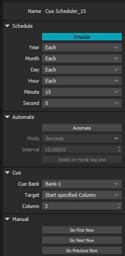

    I have an MM5 project I would like to upgrade to MM6.
    A cue was triggered every 15 minutes using the cue scheduler.
    It was very easy since "Hour" could be set to "Each".
    However with the new Timeline Scheduler "Each" is only supported for Year and Month.
    How would you do it?

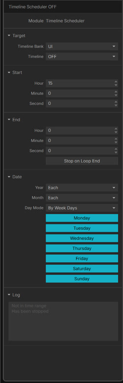

    Okay, that makes sense.
    One problem is that the timeline scheduler module does not check its state when it gets activated (just when changing time values).
    I have the case where with OSC an On and Off cue should be controlled either manually (osc directly triggers cue) or scheduled (scheduler module turned on by OSC).
    Now if one switches to scheduled mode from manual mode the scheduler does not trigger anything even if the current time is in the range between START and END time.
