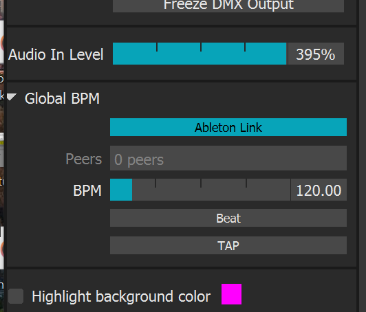

    I have Abelton 11 (Intro edition) running at 80 BPM in arrangement mode and MM set to "Abelton Link" (both on same machine), but I don't see any difference in (say) strobe speed when I increase/decrease the BPM in Abelton.
    What does the Abelton link actually do? Do you need to set something in Abelton (some macro perhaps?)

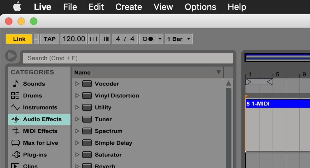

    Did you enable Link in Ableton ?
    Screenshot 2021-04-07 at 18.32.34.png (93.84 KiB) Viewed 3732 times

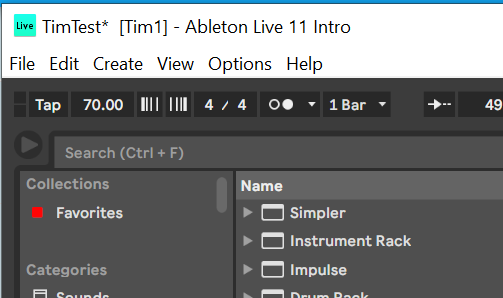

    On WIndows 10 and Abelton 11 Intro edition I don't see the Link option UI.
    Abelton help says "As of Live 9.7.1, Link usage is only possible with ASIO drivers. If Direct X/MME is selected in Audio Preferences, Link will be automatically disabled and therefore not show up in the Live Transport Bar."
    I don't have ASIO drivers (I have Direct X/MME) so it would appear it doesn't work :-(

    Sorry I wasn't aware Live needed ASIO for Link to be available... Annoying.
    ASIO4ALL is indeed an option!
