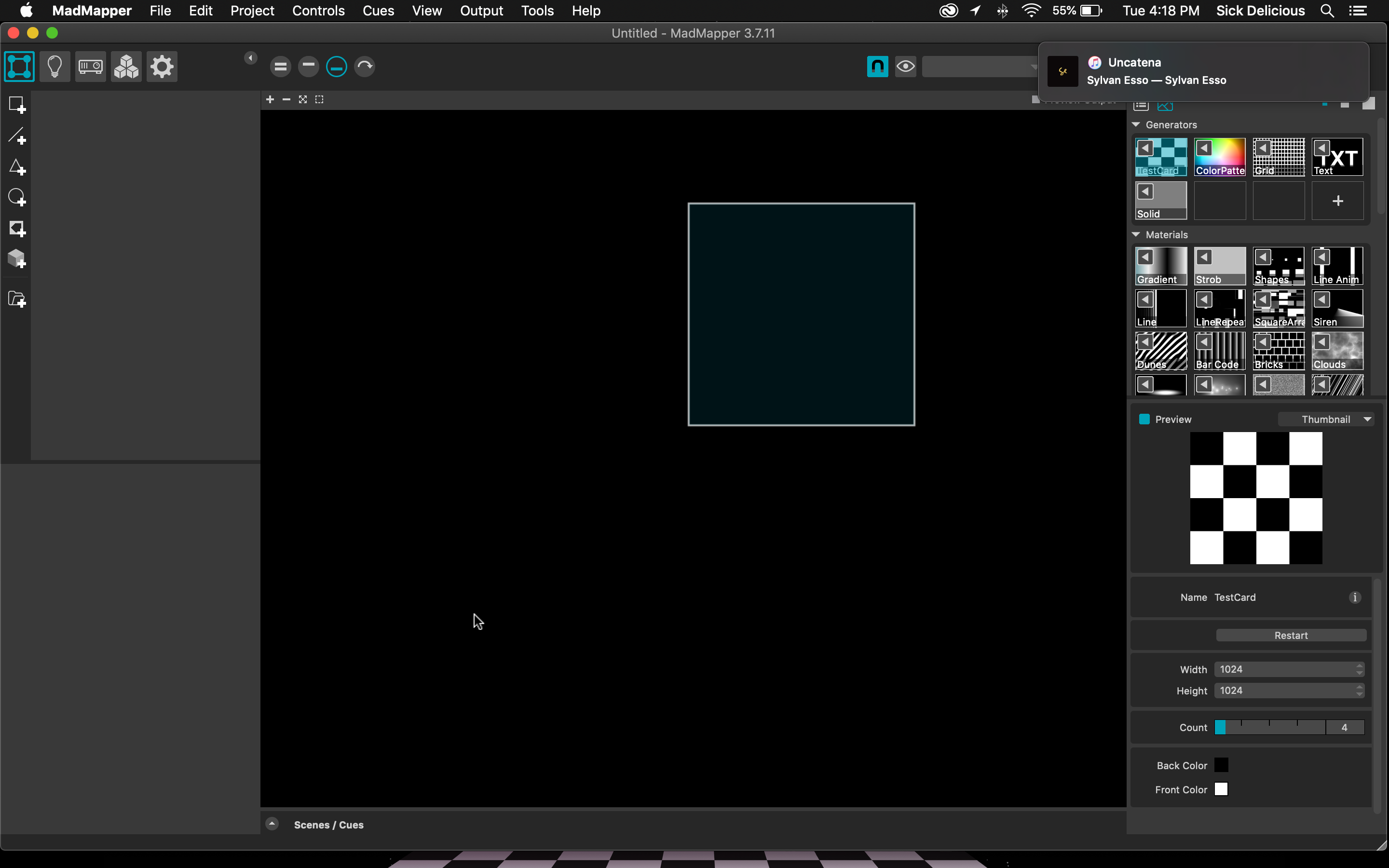

    When trying to make a selection the cursor is selecting the area to the top right of it. So if I want to select a point I have to drag my cursor down and to the left to make up for the cursor being off. Is there a way to reset it? I tried uninstalling and reinstalling, downloaded from your space but it's still off center. I ended up using the older MM 3.7.8 the cursor is fine and working as it should. Please let me know If there is a fix for this. Thank you.
    Attached is an image showing how far off the cursor is from the selection. The cursor should be at the bottom left point of the selection as I dragged the cursor from the top right to bottom left diagonally.
    Screen Shot 2021-07-20 at 4.18.16 PM.png (517.81 KiB) Viewed 2251 times
    Re: Cursor is off center (Madmapper 3.7.11)
    by mad-matt » Thu Jul 22, 2021 1:05 pm
    Thanks for reporting. You can redownload MadMapper 3.7.11 form yourspace, we updated the build to fix this issue.
