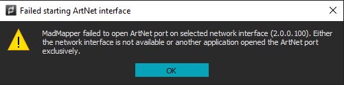

    When I try to choose my ethernet port as artnet output to control LED pixels it gives an error saying: Madmapper failed to open port on selected network interface (...). Either the network is not available or another application opened the ArtNet port exclusively. (Put the text here for people troubleshooting the same problem.) What could be the issue? The problem occurred with Madmapper 5.0.0.

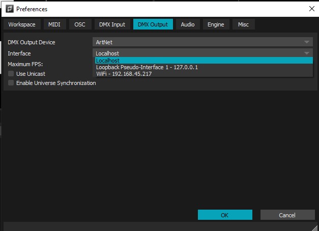

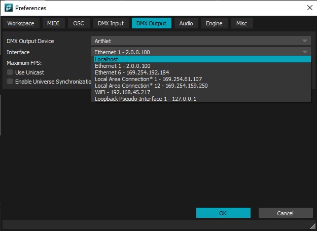

    Here you go. One screenshot is of Madmapper 5.0.7 and 5.1.3 output list. It's the same across these two versions. The other screenshot is 4.2.1. output. I installed three of the newest versions for troubleshooting.
