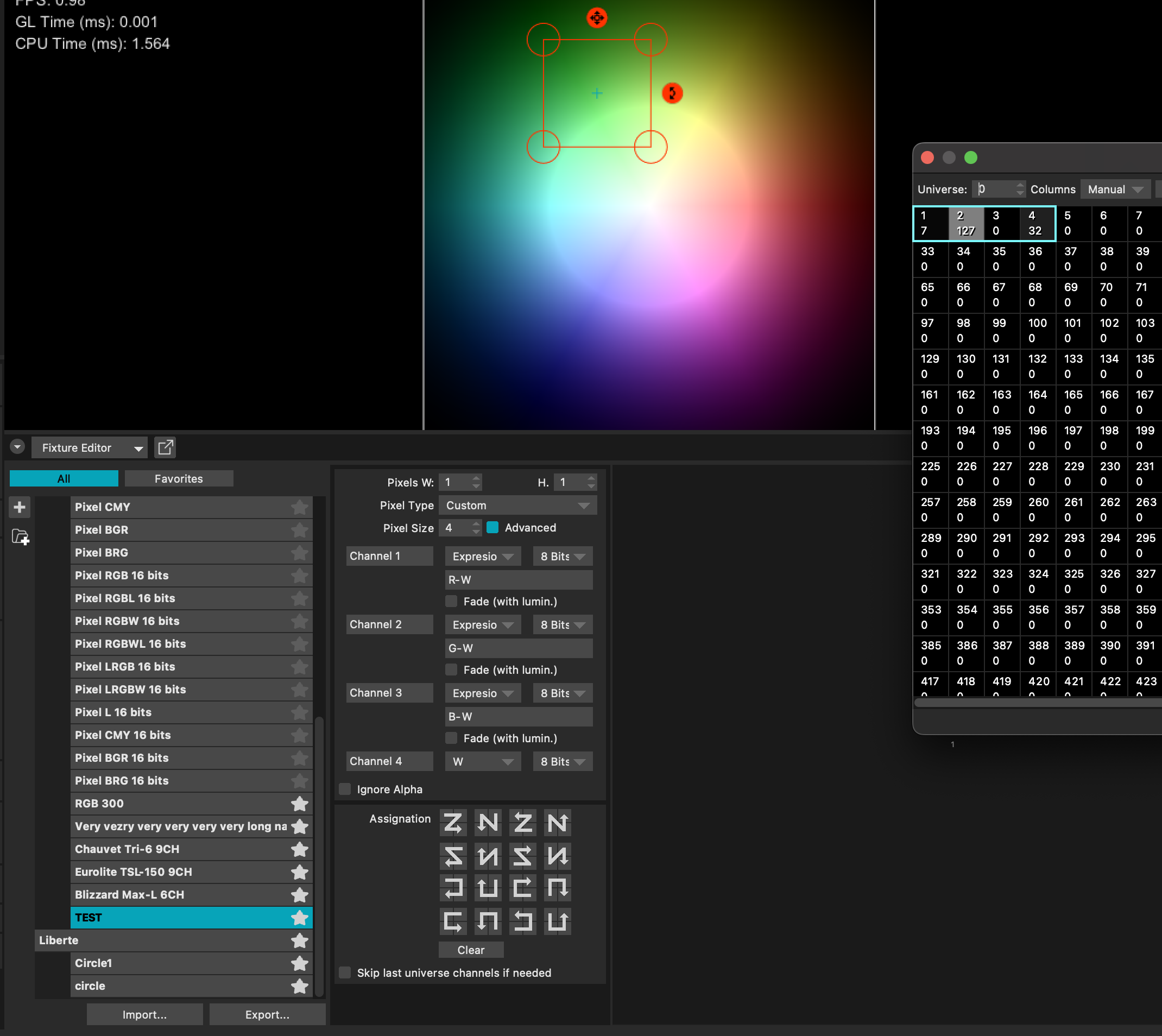

    I don't see any issue with those expressions in version 5. Check attached screenshot.
    A common issue is when user unpatch the pixel in the right part of the fixture editor. In version 5.2 we'll make it clear when pixel is unpatched. Actually you have to be sure you the a "1" in the right part.
    Screenshot 2022-10-13 at 20.35.34.png (687.49 KiB) Viewed 1984 times

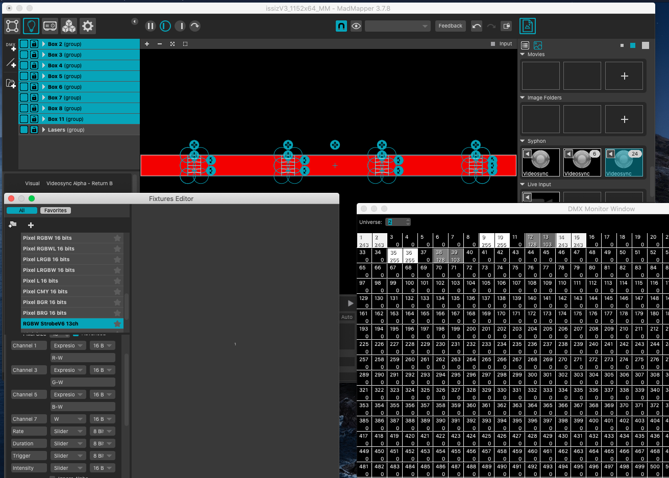

    This is a screenshot from MM3.7.8:
    You can see in the DMX monitor that channel 1 & channel 2 = 243.

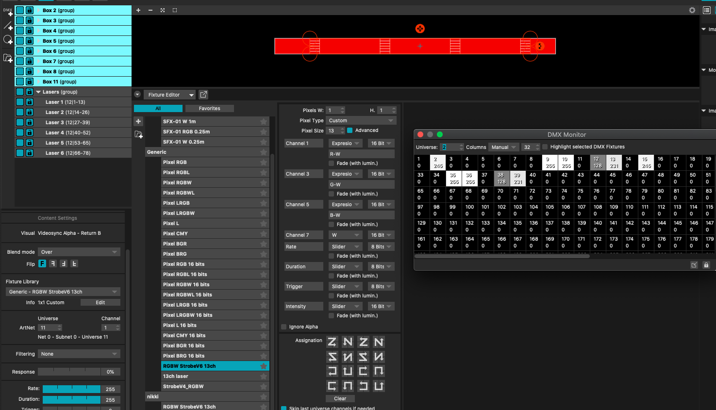

    Now here is the exact same situation in MM5 (the videoinput is exactly the same):
    And suddenly channel 1 = 0 and channel 2 = 245.
    I think this is why my setup does not work properly anymore.
    Why did this change?
    Thanks in advance,

    MM3.7.8
    Screenshot 2022-10-14 at 15.09.55.png (289.59 KiB) Viewed 1971 times
    MM5
    Screenshot 2022-10-14 at 15.14.55.png (226.33 KiB) Viewed 1971 times

    We could solve this issue. The actual workaround (waiting for MM 5.1.7 release) is to add braces around your expressions, ie replace "R-W" with "(R-W)"
    Thanks for reporting !
