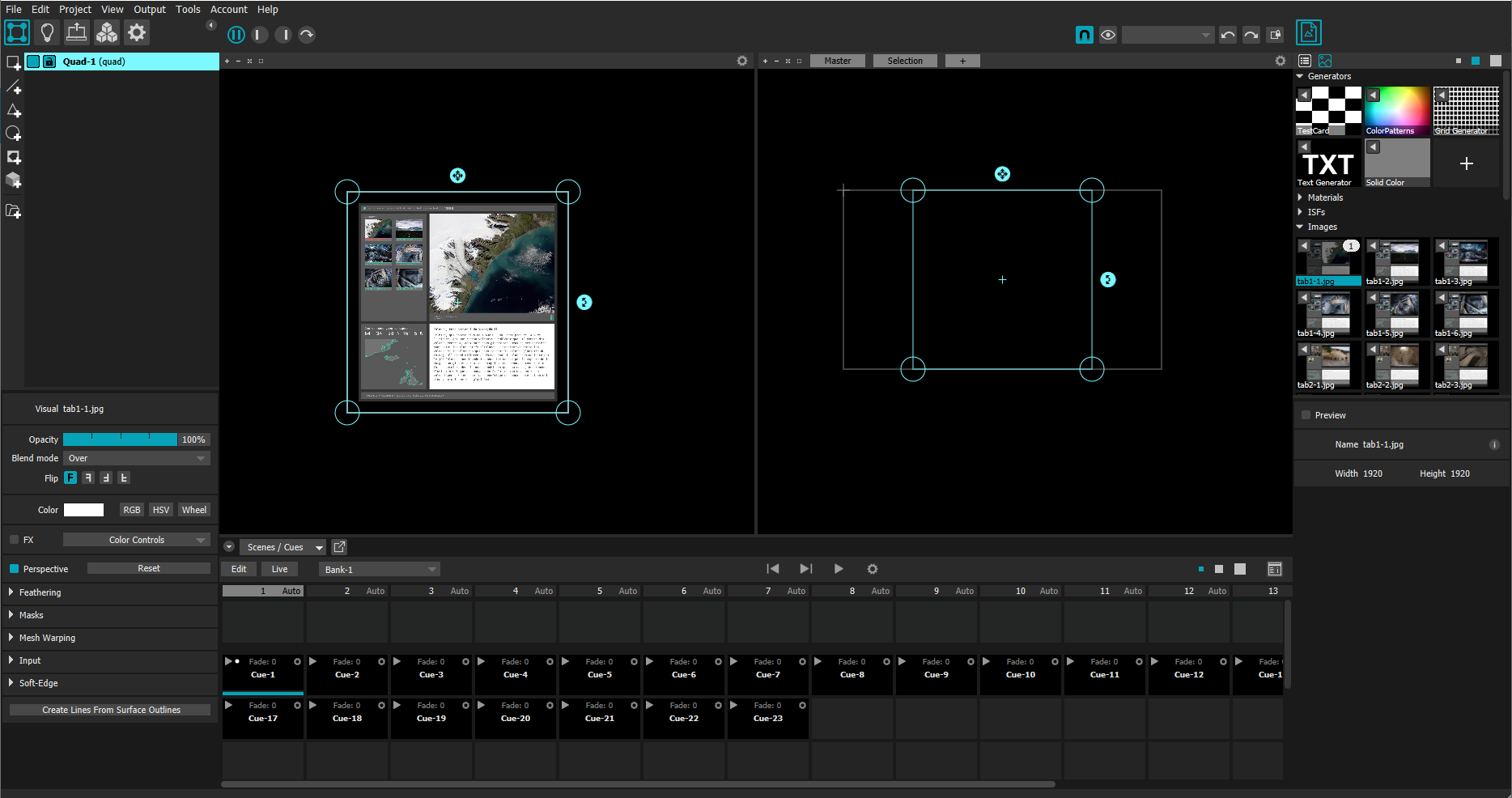

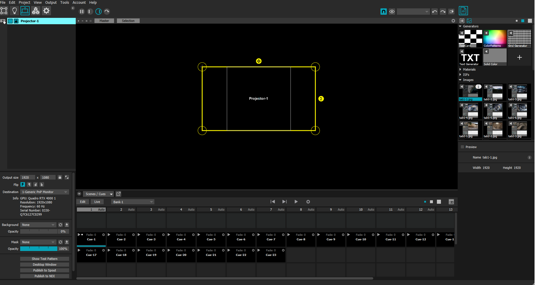

    Noob here. I have a file with quads that I can't mirror at all to any output. See attached screens.
    I'm willing to give more detaila bout context, but I don't really know where to start. Help is appreciated. It worked fine until today, for unknown reason.
    screen madmapper 2.png (116.91 KiB) Viewed 1770 times
    screen madmapper.png (212.03 KiB) Viewed 1770 times

    by mad-matt » Wed Oct 26, 2022 1:24 am
    Your output is black indeed. Various possibilities:
    - Check the the Master Level & Master Video Level are at 100% in the master tab (last tab in the panel on the left)
    - Try to change your quad surface Blend Mode to "Ignore Alpha", in case there would be an alpha channel at zero in your image
    - Check that you haven't created any mask or enabled mesh warping on the quad
    If you still can't understand, please share your project file
