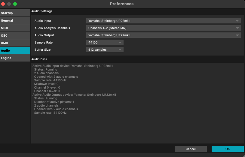

    I am trying to set up visuals for an exhibition. I'm working with ableton and I'm trying to control garage cube led lights using audio which is playing in ableton (eg. amplitude, bass etc.). Now, I am trying to route the audio signal through my audio card (Steinberger UE22 mk2) so that Madmapper picks up the signal directly. Madmapper recognises the device in the device in the settings but whenever I want to for example, control the animation speed with the amplitude of the audio which is playing, Madmapper only shows me "audio input:madmaper". So my question is, how to I get mad mapper to recognise the audio signals which are coming through my audio card.

    It seems that MadMapper doesn't see any audio device with audio inputs. When you select an audio device, there's a status text below that shows available number of input & output channels. What do you see there ? A screenshot of preferences / audio might help

    Hi, I'm on Mac.

    Audio Input "MadMapper" in controls means it's using the device you've chosen as audio input in preferences. The device selection shouldn't appear in Controls List, we'll check that.
    So it should work without problem if you have some audio coming in on channels 1&2 of your device.
