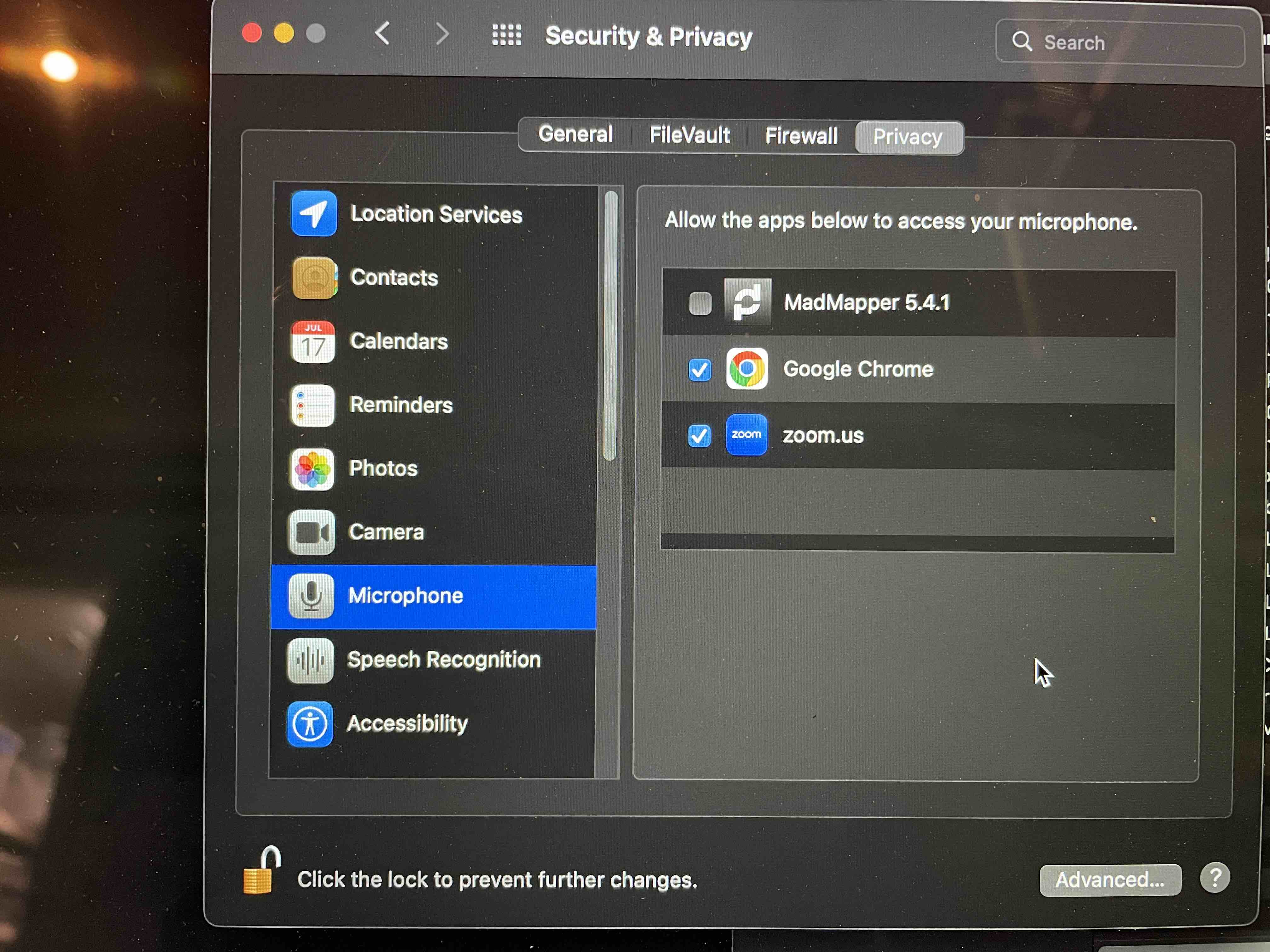

    I was trying a different brand projector and same issue. However, no issue on a Win 10 machine so I figured it was the Mac OS.
    Alright, after more searching I found a fix and apparently I just needed better search terms.
    The solution is to disable to microphone in MadMapper and also in the Mac OS System Settings.
    Although I do not use the audio input feature from the laptop microphone much this may be an issue as for the new Mac OS update it appears this Security and Privacy feature is baked in and can not be turned off.
    See images for settings config that show what needs to be clicked to get this orange dot in the upper right hand corner to turn off.
