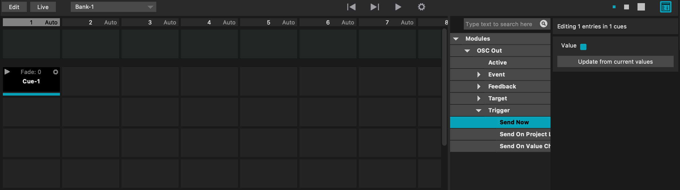

    I'm new to MadMapper, and am unsure if I'm using Modules correctly...
    I want to send an OSC command to external software after a certain cue plays... I dragged the Module with the OSC command to a new Cue, and played it, but the Module is not triggered.
    I know the Module works, because I can click the "Send Now" button, and that is successful...However, is it possible to trigger this module with a Cue??

    In the cue inspector, you have to check the "Trigger / Send Now" parameter
    Screenshot 2023-12-11 at 11.20.40.png (114.91 KiB) Viewed 8636 times
