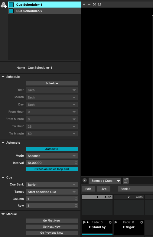

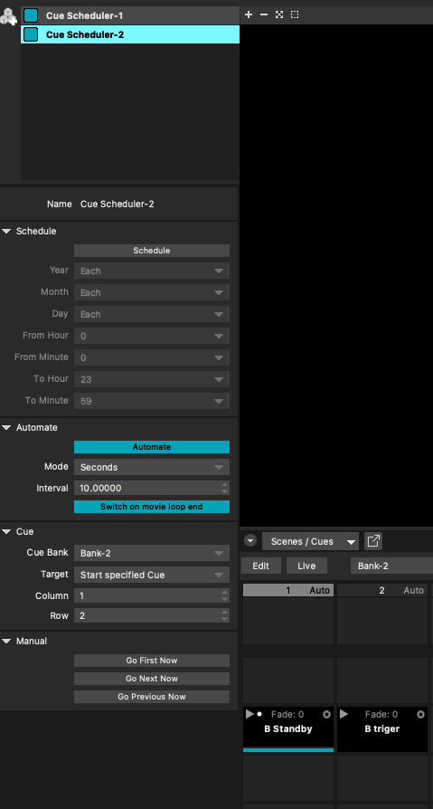

    hi guys, I have searched this on the GarageCube forum, without finding this specific problem, possibly a Bug?
    When using 2 instances of the CUE SCHEDULER, on 2 different cue-banks. Each scheduler targeted to different specific row and column, Scheduler on Bank 1, also affects to Scheduler on Bank-2, on movie file end.
    I don't know if I'm explaining myself correctly, but any help much appreciated Im really stuck with this... All I need is 4 cues.
    Bank1
    Cue 1-1 LOOP , CUE 1-2 Trigger > play once, back to Cue1-1)
    Bank2
    Cue 2-1 LOOP , CUE 2-2 Trigger > play once, back to Cue2-1)
    Currently Cue Scheduler instances are affecting to both Banks!?
    Anybody else having similar issues with Cue-Scheduler?
    Thanks in Advance and apologies if this is total user error.
    Screenshot 2024-01-24 at 14.07.42.png (50.97 KiB) Viewed 2072 times
    Screenshot 2024-01-24 at 14.07.02.png (49.14 KiB) Viewed 2072 times
    Re: CUE SCHEDULER BUG?
    by mad-matt » Wed Jan 24, 2024 10:48 pm
    "Switch on movie loop end" is reliable only if using a single movie. It's a shortcut that fits lots of projects but indeed not all cases are handled. We're working on a much better approach (except something by the end of the year). At the moment there still might be an option for you: you can trigger something when a specific movie playback finishes, see
