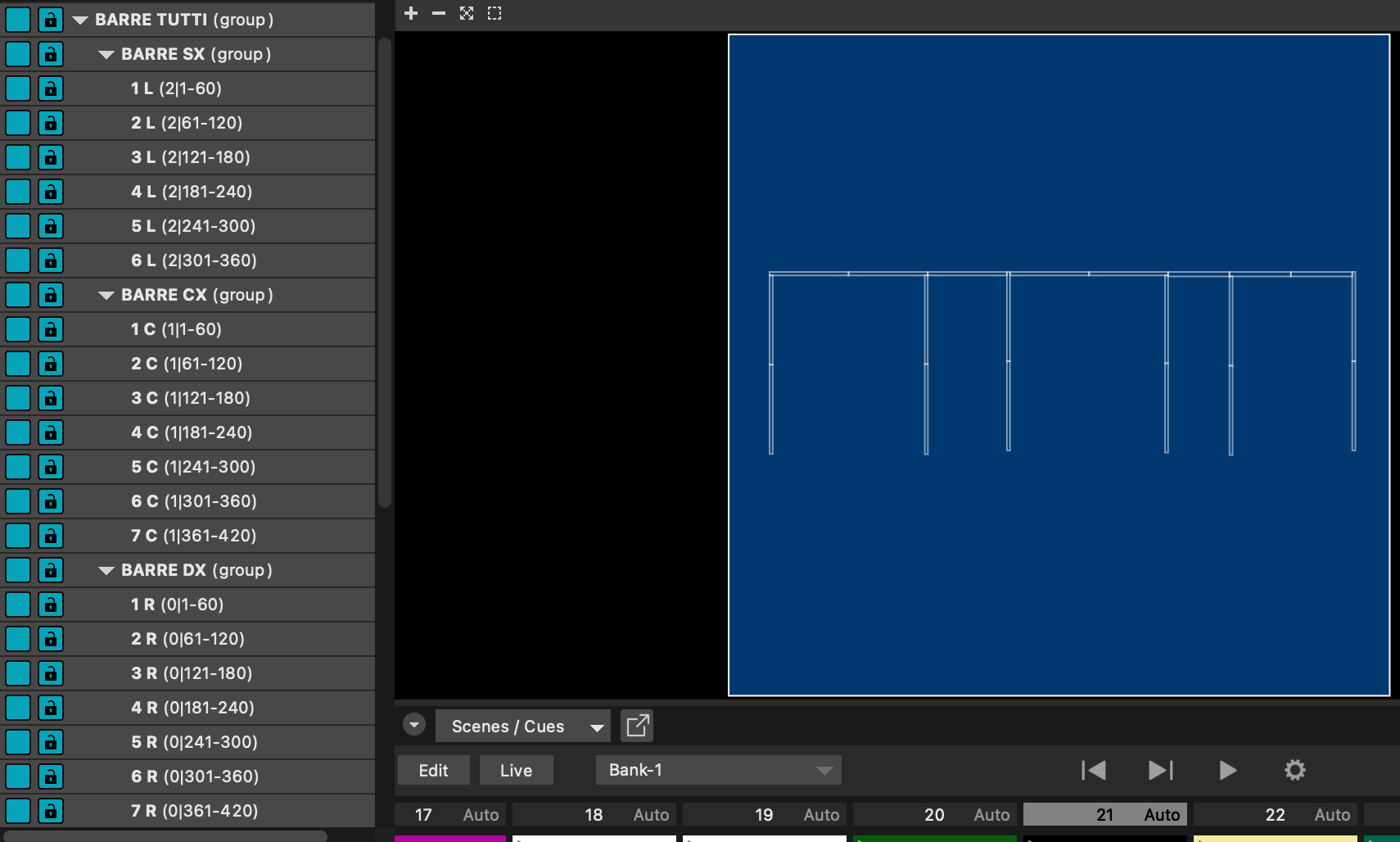

    Hi to all! My name is Fabio. I've recently increased my led bar setup with a new order, the products and software are amazing!
    I need to know what is the easiest way to add all the new purchased led bars in all of my scenes/cues previously created. I've done it well on only 1 scene, but i don't understand how to mantain this setup in all the scenes/cue, replacing the previous setup.
    I've tried to copy/paste in all the scenes, but in this case there's a lot of work to do, cloning the setup, and regrettably I'm losing all the midi-controlled automation to the parameters... :-(
    Here you can find 2 screenshot to understand better the situation: https://drive.google.com/drive/folders/ ... sp=sharing (also in attached to this topic)
    Please someone help me! Thanks so much in advance. Greetings from Italy :-)

    Thanks Matt. The problem is that when i drag the new correct DMX fixtures in a new scene/scenes, also the related media are copied... that means I'm losing my previuos created scene/scenes ...
    I need only to copy/modify the setup with new added led bars (and the related new positioning and DMX address) to the old scenes, but not the media related the old scenes. I hope I'm explained well my problem, and sorry for poor english. Thanks again!

    UPDATE / SOLVED WITH MY METHOD
    1 - I've added to the project all the new bars/fixtures, configuring properly the new DMX address, according to my new expanded setup
    2 - I've created a new scene, and in that scene I'm start to positioning and dimensioning well the new bars (in terms of fixture rotation, placement and size), but non finished yet completely
    3 - I'm going in EDIT mode from that created scene, then I select all (cmd+A) all the cue/scenes, and then, very carefully, I've start to complete the perfect positioning for my setup: turning all "red" the "yellow" parameters, but absolutely not touching the "media" related section. In this way, all the scenes/cues mantain the original assigned media, but with a new placement of the bars/fixtures. Exiting the EDIT mode, now ALL the scenes/cue have the same new setup/position, but with the previous programmed medias.
    4 - Scene by scene, cues by cues, I've turn on the new bars/fixture, already positioned, "simply" updating the values for each (add all).
    5 - Done! :-)
    My personal consideration: I think it's a really bad & boring way to expand a LED setup, especially when you've already programmed over 50 scenes/cues with different medias... and this need to happen every time u need adding or modify the main setup... hope in the future there will be a more easy and fast way to do it. Or... just simply I've not understand the software :-) Hope this can help someone.
