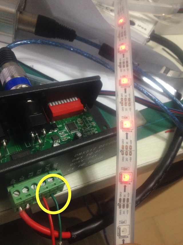

    continue my wired experience, this time i try to use ws2811 5v, when i plugin 3 wires: positive, negative, and data, there is no response, totally dead!
    BUT! when i unplugin the wire of negative, it show me a little while red light!!! check my photo attachments
    connect the ws2811, no response!

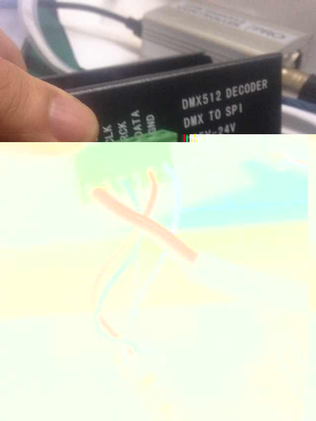

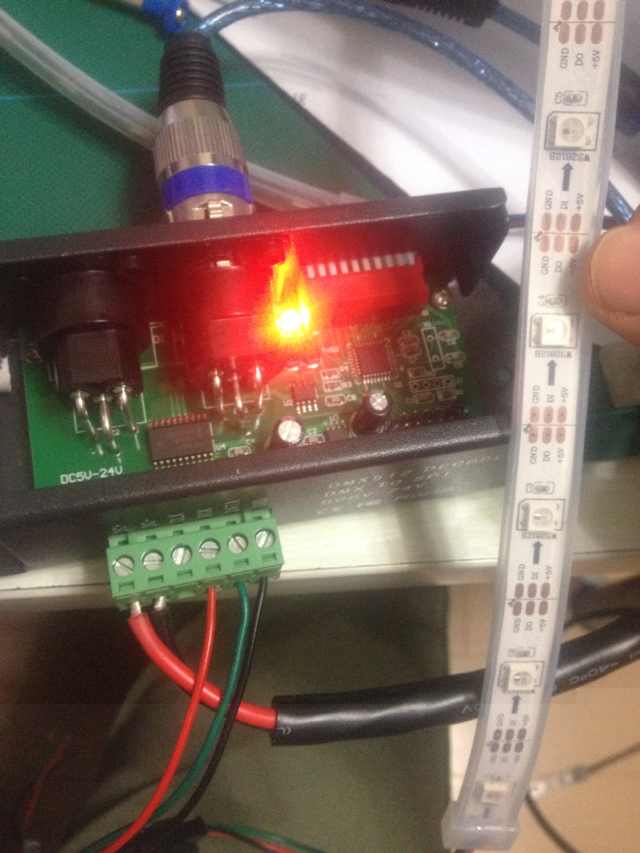

  • axistudio
    Posts: 7
    Joined: Thu Apr 10, 2014 6:18 pm
    Re: 100 bucks for a solution of addressable LED issue!!!
    by axistudio » Thu Apr 10, 2014 8:47 pm
    The weirdest thing i ever met! am i meet some tricky ghost!?

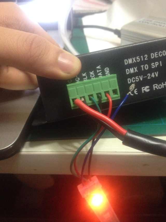

  • axistudio
    Posts: 7
    by axistudio » Thu Apr 10, 2014 9:13 pm
    SAME F**KING situation with ws2801!!what the hellllllllll! check the photo ! anyone has any idea!?
  • Xaver2k
    Posts: 103
    Joined: Thu Feb 20, 2014 11:23 pm
    Location: Germany
    by Xaver2k » Fri Apr 11, 2014 8:17 am
    are you using the same controller for both led strips??
    sure that the controller configuration is right?
    what is the "RCK" pin on the controller?
    i had also many problems with my ws2812 at the beginning...
    do you some cut somewhere? if yes put the first strip away and try from there.
  • .lov._
    Posts: 17
    Joined: Wed Jun 12, 2013 8:11 pm
    by .lov._ » Fri Apr 11, 2014 10:16 am
    First of all, the strip requires only 3 wires, you are using 4...
    Data should be connected to D0. GND to GND then 5V to DC+.

  • Xaver2k
    Posts: 103
    Location: Germany
    by Xaver2k » Fri Apr 11, 2014 2:04 pm
    @.lov._
    he has some ws2811 and some ws2801 strips
    yes the ws2811 have 3, but the ws2801 have 4wires!
    And the data connection has to be connected to "DI"!
