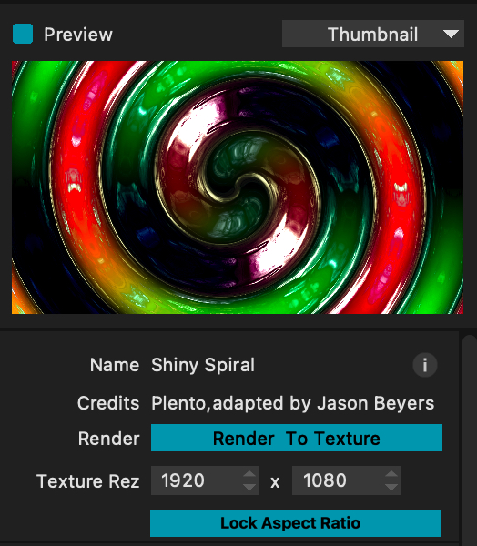

    Feature request: lock aspect ratio button for materials in "render to texture" mode, to produce 1080p output from what would normally be a square.
    I've been converting many many ISFs to materials, to gain better control over the shader speed. When using these materials with surface FX, I need to enable texture mode for the materials to work with those FX.
    For projects that output a 1080p format (say, a single non-commercial projector), it's easy to map a 1024x1024 material (or higher-resolution square, in texture mode) to a 16:9 quad. However, this poses a performance problem: the unused edges of the texture-rendered material are *still* introducing load on the GPU.
    I discovered this in a big way, in a recent project: I was using a very GPU-heaver material shader, and the material version of the shader (in 1920x1920, with sides cut off via input map to give me 1920x1080) was giving me far lower FPS than the original 1920x1080 ISF. I got around this by throwing a direct-rendered version of the material on a 1080p virtual projector window, and routed that to another quad with syphon/spout -- and voila, things were perfectly matched FPS-wise with the original ISF.
    I would love to employ this strategy for everything, but that can produce a mess of syphon/spout routing chains & extra surfaces, and those texture-sharing protocols do take up GPU memory.
    So, the idea: add a "lock aspect ratio" button for materials, that will become visible when "Render to Texture" is enabled. The button would enforce a 1:1 aspect ratio no matter what the user-defined "Texture Rez" is, allowing users to produce 1080p content from a material without going through any of those syphon/spout hoops & without burning GPU resources on unused pixels.
    I've attached a screenshot and a mockup to this post:
    * Screenshot "current_wrong_aspect_ratio.png" shows what it looks like when you try to set "Texture Rez" to 1920x1080 for a shader that should show something perfectly round
    * Mockup "desired_lock_aspect_ratio.png" shows an idea for this "lock aspect ratio" button, producing the expected 1080p image while retaining the roundness
    I think this would be a big win for the folks who have invested time into migrating content to Madmapper's proprietary material format.

    Re: "Lock aspect ratio" button for materials in texture mode
    by franz » Mon Feb 14, 2022 1:47 pm
    can't you just edit your material and multiply uv.x by 1.77 ? - or whatever ratio you need -

    Update: I’ve solved this on the material side. If you take a look at the 15 most recent materials I’ve published in the library, you’ll see a “lock texture aspect ratio” button at the bottom of the shader controls for each. Seems to work well
