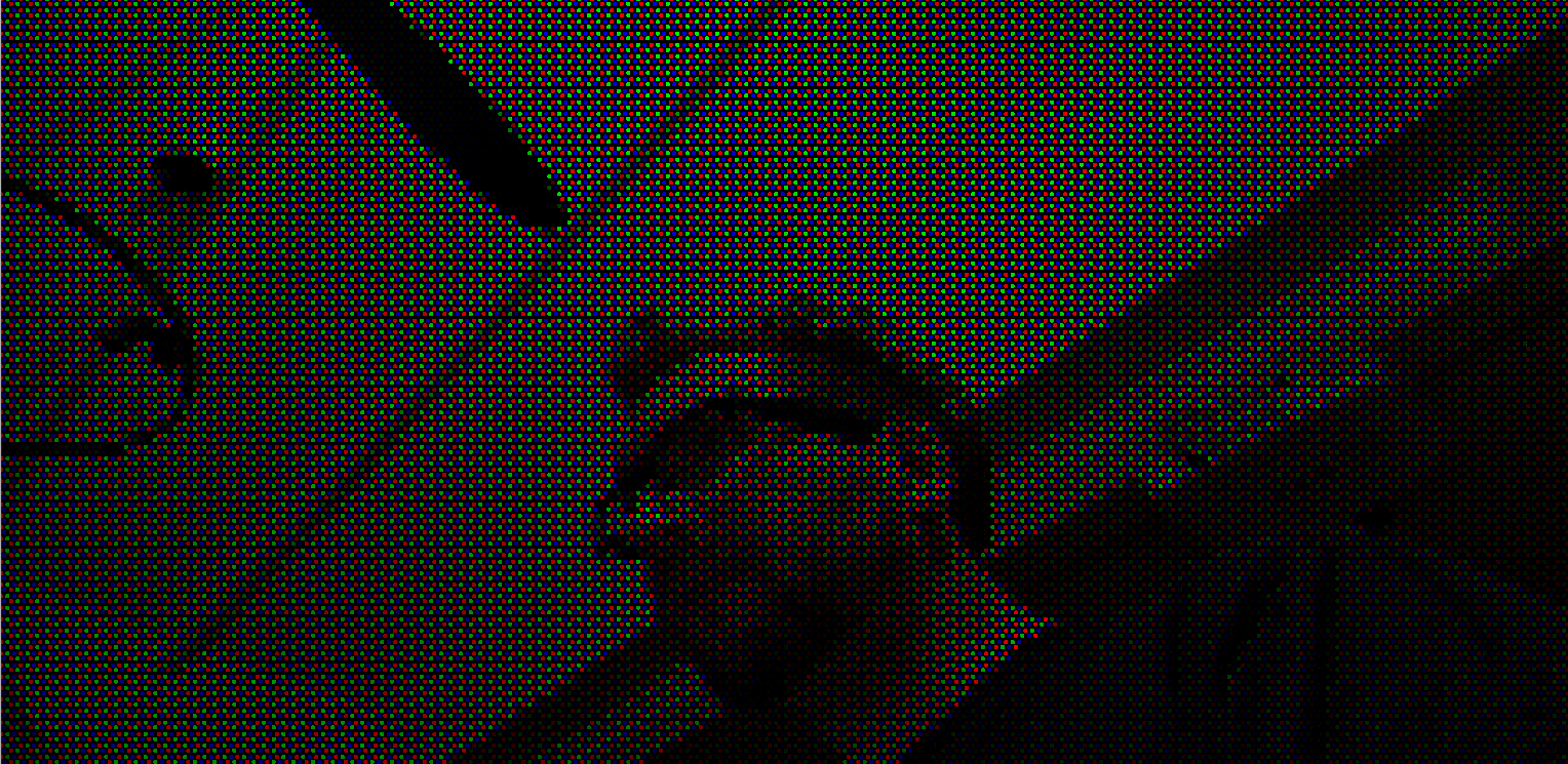

    Hi all,
    Spent a few hours looking into creating this myself, but despite not being a complete luddite, gave up; What I am trying to achieve is a performant filter that takes a video signal and converts it into what in the old CRT TV/Monitor world was called "Shadow mask - a tightly stacked array of red, green, and blue dots, illuminated as per the brightness of the corresponding colour component of the pixel examined.
    I have achieved something like this in Processing, but it is painfully slow (the idea is to render onto a 1920 by 1080 surface, whereas we'd be only using something like every 6th of the inputs original input pixels in either dimension (rough example attached).
    I assume with a glsl and/or ISF, this would be much more performant, but having trouble to draw and locate simple circles with that technique (tried my luck modifying a couple of ISF's online, too)...
    Here is the code I used in Processing, not that it will be much help I guess, but to show the technique of building the triangles of circles (every second one inverted, and arranged as to avoid any colour repetitions):

    I assume that for someone who knows what they are doing with shaders, this will be a quick job, but yes - any help / pointers / would be appreciated!
    Here is a rectangular RGB split effect I forked off in ISF, so as long as the shapes could be manipulated to become circles in a particular pattern/arrangement, this would be perfect: https://editor.isf.video/shaders/62f645 ... 001afa2e1a ...
    Screen Shot 2022-08-12 at 11.59.43 pm.png (704.76 KiB) Viewed 10516 times
