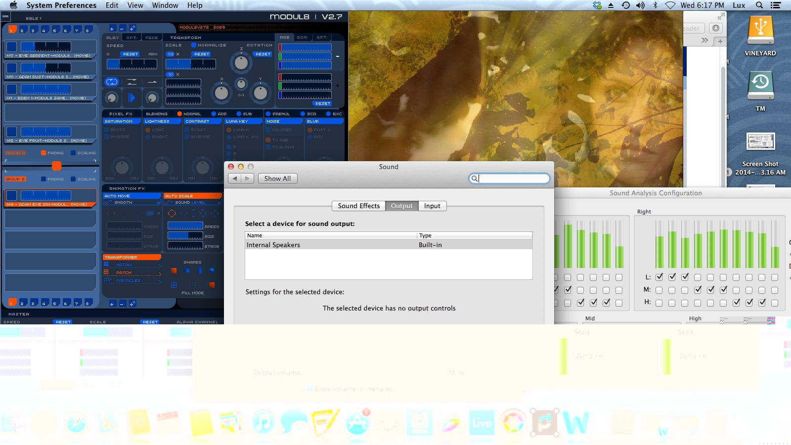

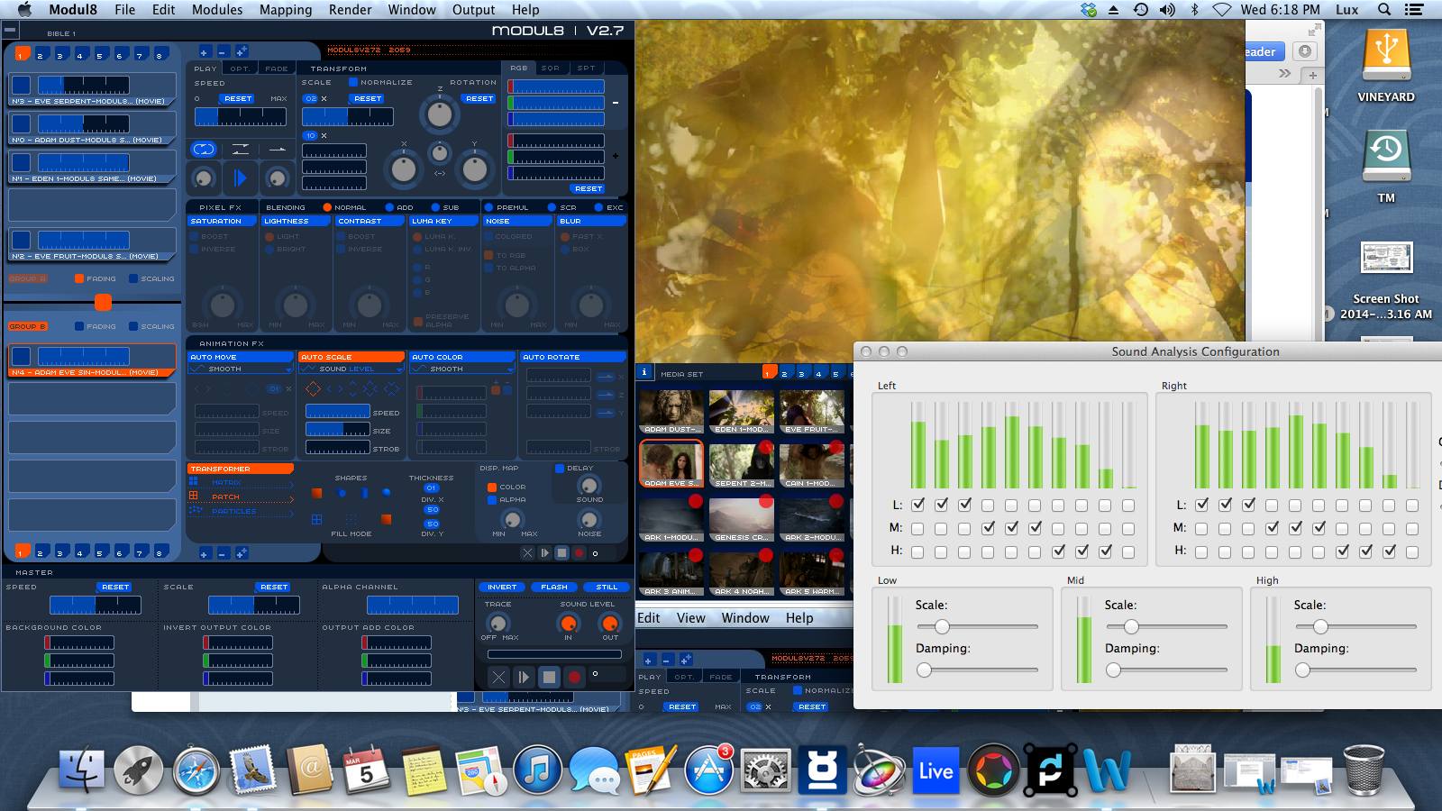

    I am having issues hearing sound through my Mac Mini, let me describe the setup and show a screenshot:
    iPhone > 1/8" cable > Mac Mini input port > out through either headphones, internal speaker, or external speaker
    I see audio playing through the sound analyzer, can get system sounds through the sound output, just cannot hear what is happening from the audio in to the audio out via modul8. Sound Level knobs are on as well.
    Any ideas?
    lux

    modul8 audio out only outputs the sound from your medias, it's not supposed to reroute your audio input through your audio output.
    In order to do that, you can use the "line in" app you can find here: http://rogueamoeba.com/freebies/
