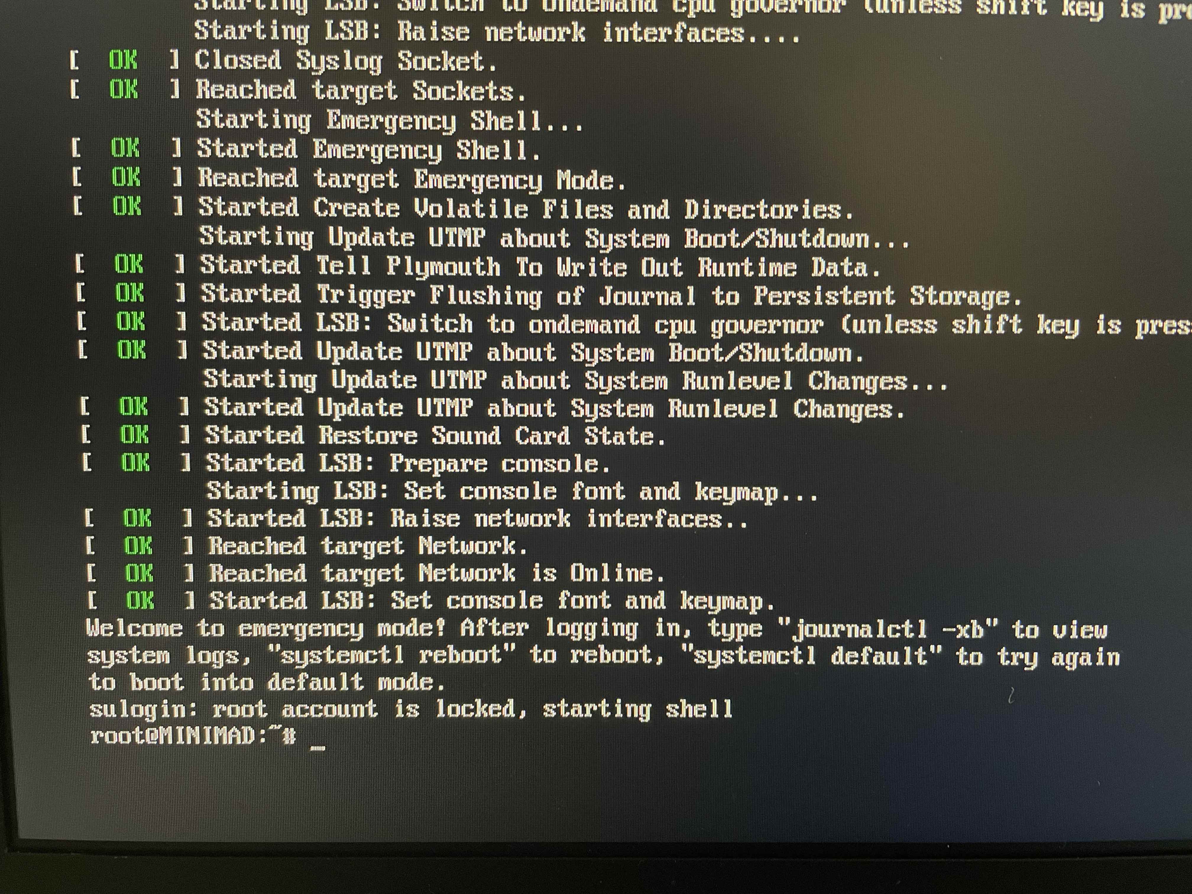

    Hi, I just updated the SD card for my MiniMad (model2) with the latest version of MadMapper. Loaded my project on the card, connected it and am getting the following message while booting:
    Welcome to emergency model After logging in, , tupe
    "journalctI-xb" to view
    system logs,
    "sustenctl reboot" to reboot,
    "sustencti default"
    to boot into default mode.
    to try again
    sulogin: root account is locked, starting shell rootoMINIMAD:
    _______
    Please see attached image.
    I can't get past this part. Any advice how to solve this? I need this for a show tomorrow and am panicking.

    This is probably do to your SD-card data being corrupted, or worse being physically damaged.
    I advice you flash the SD-card following the procedure described in the Mini user-guide that's available in MadMapper -> Help, or directly there: https://madmapper.com/minimad/userguides
    If the problem happens again after flashing, you might need to get a new SD-card and flash it the way.
