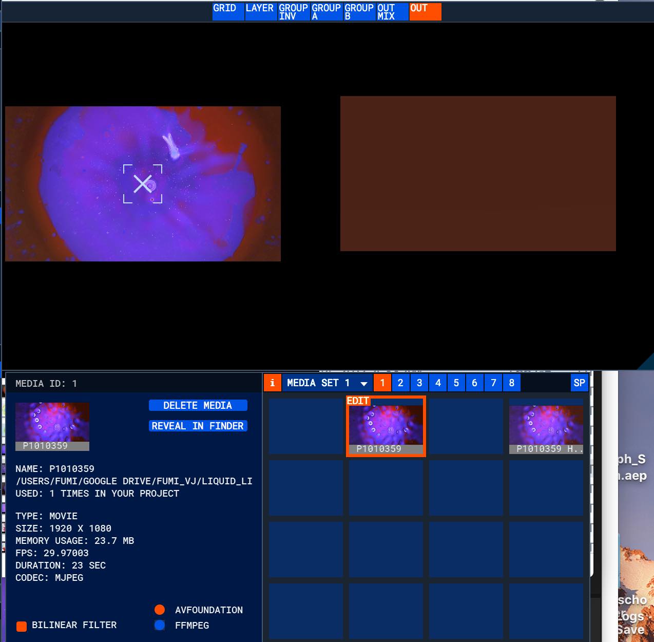

    This has been happening since early betas in an unpredictable fashion, and it is super disruptive, but I didn't have a good reliable repro until now.
    AVF sometimes renders video as a random solid color.
    Repro: I have the same footage encoded a MJPG and HAP. Put both in modul8, in two layers, move them left and right so I can watch both at the same time. In the media info tab, verify that MJPG version defaulted to FFMPEG decoder, and HAP is only supported by AVF. Switch the MJPEG clip to use AVF decoder. The hap clip turns to a solid brown.
    Obviously this should never happen, and it is extra odd that decoding of different clips in different layers is not hermetic. The fact that different clips can impact eachother through the decoding library means I have some projects that are very unstable; making simple changes (swap a media in a layer) sometimes totally breaks something somewhere else or later in the performance.

    Screenshot showing the corrupted AVF decoder
    M8 AVF HAP corruption.jpg (108.22 KiB) Viewed 26113 times

    I've been trying to reproduce your problem but couldn't using the movie files I have.
    Could you send me a link to your two HAP & MJEG files in a PM?

    by Pierre Guilluy » Mon Jul 30, 2018 5:12 pm
    I finally could try to reproduce your problem using the files you provided without success: whatever I change the actual player of the MJPEG file doesn't have any effect on the HAP files currently playing.
    What version of macOS are running Modul8 on?

    Thanks for looking into it. Too bad it isn't an easy repro on your end.
    The computer I did that test on was OSX 10.12.6 on MacBook Pro (15-inch, 2016) [the touchbar one] with Radeon Pro 455 and Intel HD Graphics 530.
    I don't have that computer with me now, but I'll see if I can repro on a different computer and send a zip file.
    I *think* I had restarted modul8, but if I did cmd-N for new project, then probably the decoding helper process stuck around, and there might be a deeper history involved in producing the bad output.
