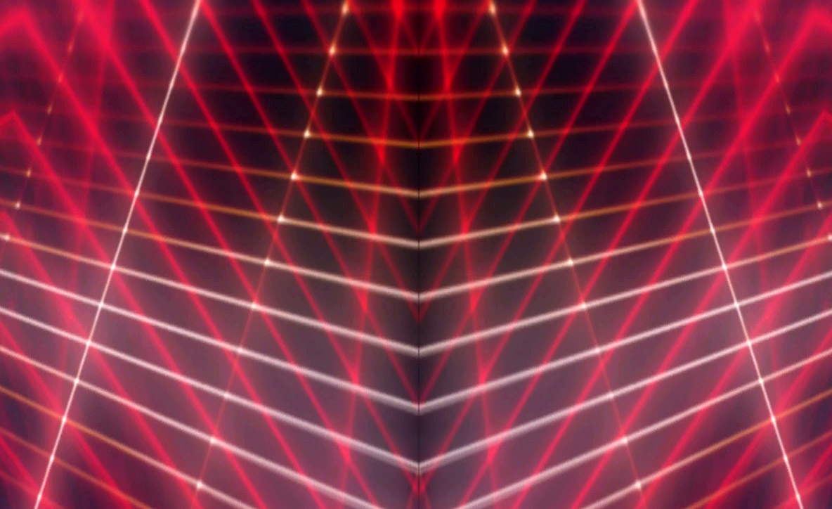

    Unfortunately the workaround fix causes some undesired effect when using the transformer matrix. As you can see there's a black line down the center from where the edges of the clip aren't filling the frame fully.
    The field of view scale seems to do a good job on plain clips - but I happen to use the transformer matrix often to give visuals symmetry when they have none.
    Hopefully a proper fix can be found! Appreciate it!
