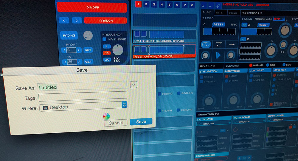

    broken
    Posts: 125
    Location: canada
    Re: System Lockup with PhotoJPEG
    by broken » Mon Oct 31, 2016 7:44 pm
    I was able to load my project fine with 100 clips.. things didn't freeze, but when attempting to re-save the project, I got beachballs and my entire system froze again.
