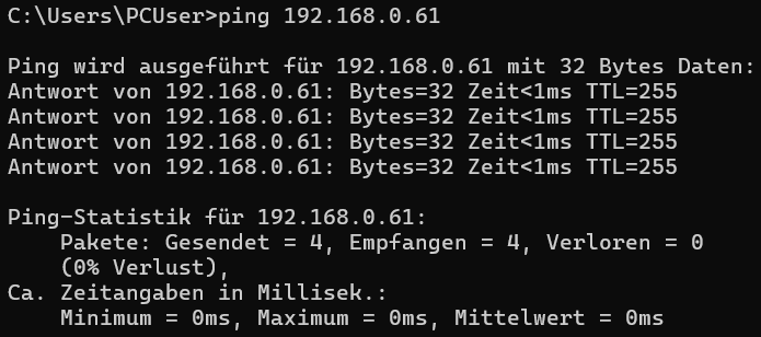

    I still can't establish a connection to the interface.
    The interface has a static IP address: 192.168.0.61.
    I can see the interface in MadMapper, and I also verified the connection using CMD and a ping test, which was successful.
    But I still can’t establish a proper connection to it.
    i can finde the Interace with the Laserworld Interface and get on the newest Update.
    Patrick
