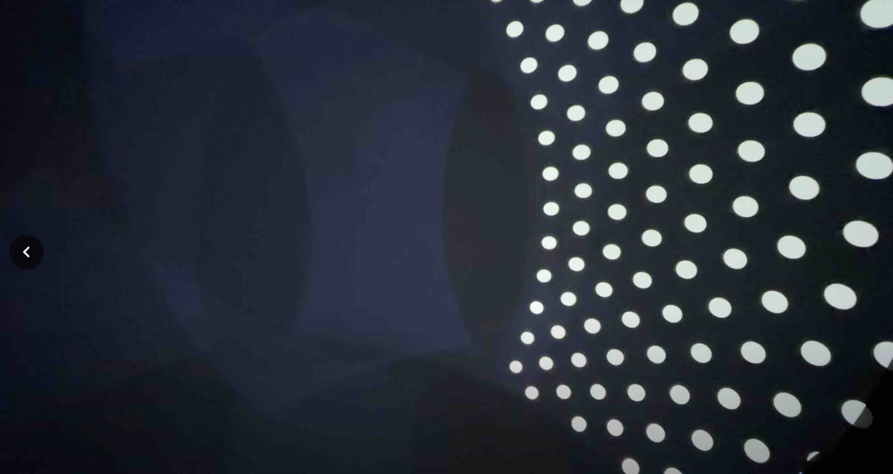

    Have you ever mapped a curved surface like a dome by hand with more than 1 projector? It's very difficult, time consuming, and often yields less than desirable results as there is not sharp geometry to map to and getting the blends perfect is virtually impossible.
    This became evident over the last year as we have done many domes.
    The solution? Use a special camera and special software. There are many solutions and they all work similarly where each projector alternates displaying some pattern of dots and lines and the camera then sees these and solves for where everything is.
    When it works right it goes from not really even possible to a perfect map in 15 minutes or less. It's straight up magic.

    One last huge feature would be to "equalize" the grey hazy boxes when you use a 3LCD projector blend. If you do stars for a planetarium the problem is most non-DLP projectors can't display actual black and so you get these kind of grey boxes for every output even though your content is black. Resolume has a hallways solution for this in Arena where you can increase the black levels to achieve a better result.
